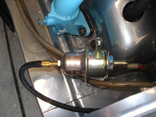

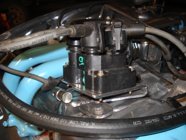

A shot of the VAC referanced FP reg and the Ford EDIS coil.
I used the original coil bracket off the ford Escort that all the EDIS eqiup was in. By cutting 1 ear off the top and welding it to the bottom, I was able to use the stock 914 coil mounting holes in the tin.
