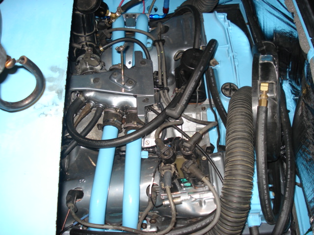

I have bounced back and forth from building the engine to getting stuff painted.
I am building a MASSIVE 1.7 (IMG:style_emoticons/default/biggrin.gif) and restoring the engine bay and most of the other areas of the back end. This car has very little rust so patching is minimal.
I'm hesitant to start a resto thead, there have been so many, but here are some pics.

the engine is in!!

toon1   It's been awhille since I've added anythin...   Feb 22 2008, 10:17 PM
toon1   A shot of the VAC referanced FP reg and the Ford E...   Feb 22 2008, 10:22 PM
toon1   Notice the second batt. cable. I wanted a better g...   Feb 22 2008, 10:26 PM
degreeoff   I'm hesitant to start a resto thead, there...   Feb 22 2008, 10:27 PM
toon1   the engine is in!!   Feb 22 2008, 10:50 PM
toon1   Now Just about everyone knows I have been working ...   Feb 22 2008, 10:56 PM
toon1   I ran the fuel line along the back of the engine b...   Feb 22 2008, 11:01 PM
toon1   Last two for now. a pic of the 02 sensor contr...   Feb 22 2008, 11:03 PM
Heeltoe914   Nice fun work Please doc, the injection system. Ca...   Feb 22 2008, 11:27 PM
toon1   Nice fun work Please doc, the injection system. C...   Feb 23 2008, 12:08 AM
