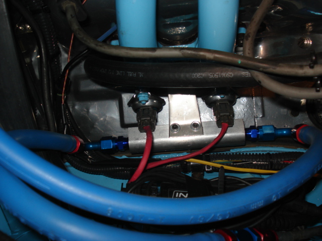

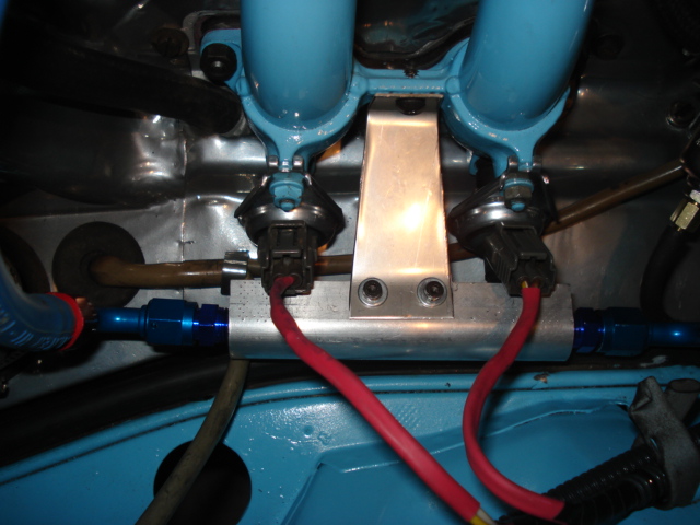

Now Just about everyone knows I have been working on a inj. retrofit( if you don't, well I have (IMG:style_emoticons/default/biggrin.gif) ).
They are 21lb/hr inj's off a ford Probe. I machined two fuel rails and used -6 AN fittings and 3/8" summit tubing for the feed line. The F.P. reg has 5/16 bfittings on it so it needed to be reduced before the reg. . the return was 6mm back the the hardline to the tank.

toon1   Now Just about everyone knows I have been working ...   Feb 22 2008, 10:56 PM
toon1   I ran the fuel line along the back of the engine b...   Feb 22 2008, 11:01 PM

Heeltoe914   Nice fun work Please doc, the injection system. Ca...   Feb 22 2008, 11:27 PM
toon1   Nice fun work Please doc, the injection system. C...   Feb 23 2008, 12:08 AM
