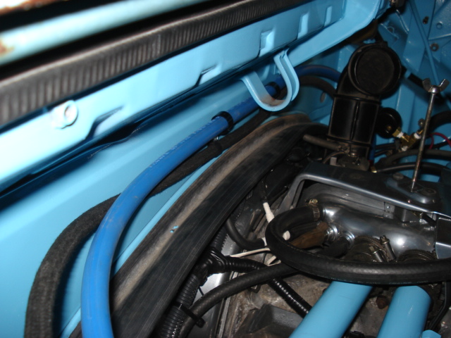

I ran the fuel line along the back of the engine bay wall, above the tin. I had it this way before the rebuild. it keeps things a bit cleaner looking.
The blues is the feed line and the black, return. BTW, 3/8 fuel line is overkill, my bad!!
