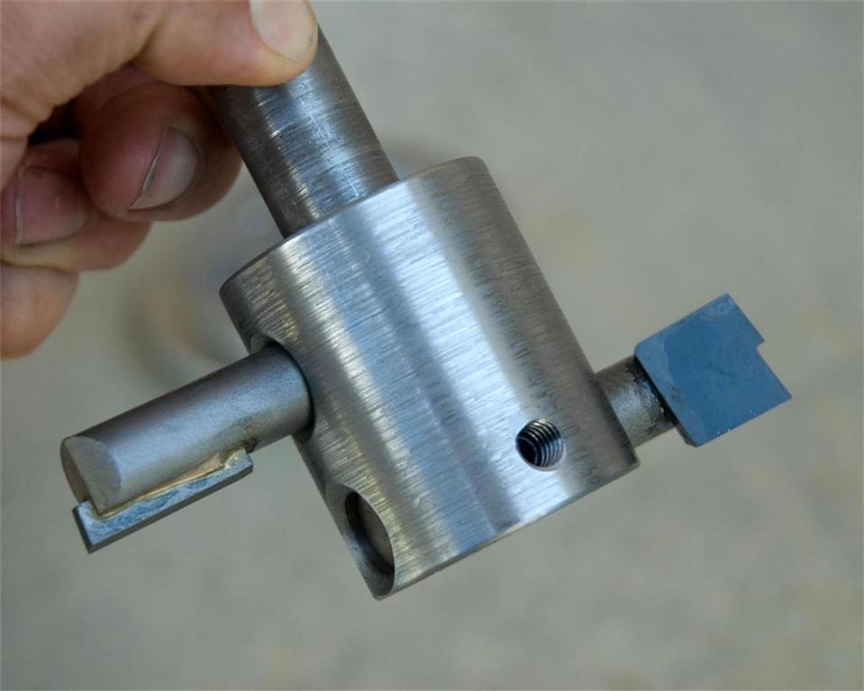

I should give kudos to this special tool Don makes and was kind enough to let me abuse. Surfaces and clearances the fin in one go, made it super easy.
The picture is of the Type 1 Tool, the type 4 is essentially the same but with different blades and heights.

brer   I should give kudos to this special tool Don makes...   Feb 23 2008, 03:17 PM
Jake Raby   That tool is in my box too... Its made by the guys...   Feb 23 2008, 06:56 PM
