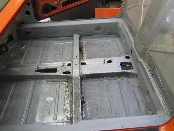

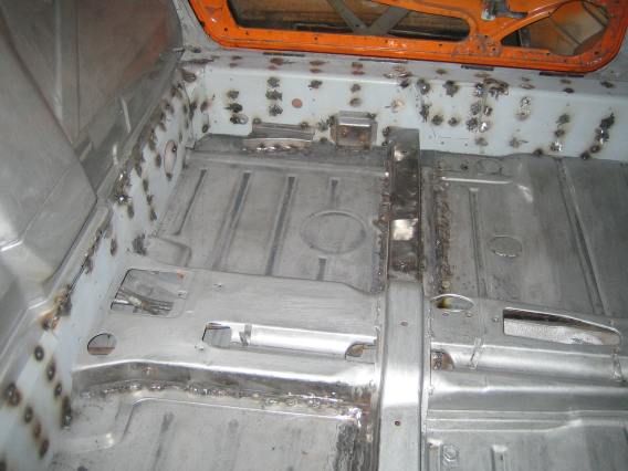

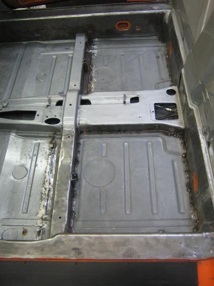

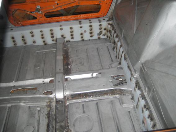

OK, spent some serious time on the car yesterday and a lot less today as a disagreement between the angle grinder and a finger (tight corner and gloves not thick enough) meant 4 hours at urgent care and two stitches.
Anyway the floor pans are in, the seat rail re-enforcement still need to go in as well as the seat mounting points but I thought I would put the Engman kit in before that.

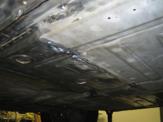

Welding under the car is interesting, took me a while to get the right settings and technique on the welder. This week I ran out of gas AND wire although a more competant user would no doubt have consumed vastly less of both.
I was hoping to get all the welding done today and then start prepping for some paint, ha, best laid plans.
Here is a pic of the inside, and underside of the new pan.
I then sprayed where the Engman kit goes with weld thru primer (anyone spot the access hatch a previous owner thought might be a good idea?).
I spent quite a while getting the fit of the drivers side right, the inner long is far from square and I did the best I could to get it to metal to match the contours before I started welding. I thought the passenger side was better but I should have spent more time with it.
I was taking a break from welding to do some grinding, anyway it is coming on and hopefully I will get some eve time in this week.
