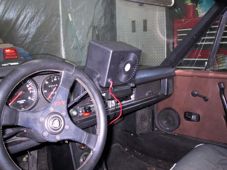

I wouldnt think they would give off enough heat to make it worthwhile. I have been using an electric heater for my car as a temporary solution. I think some sort of collector around the header is still the way to go. I dont drive my car during the winter here in Minnesota but the electric one worked fine at temps below freezing. It throws enough heat to keep the cabin warm and kept the windshield clear. I Still think header or engine heat is the way to go, I did considered my front mounted oil cooler as a source but it takes way to long to get warm running through the thermostat. Im sure you would get some warm air out of the install but I doubt hot air.
