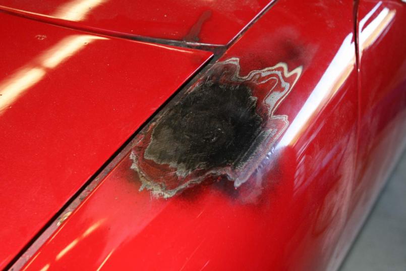

So I've decided to confront a few rust bubbles on my car, before painting it (the car looked great, but I never liked the wavy sides due to poor prep and no blocking).
If you can't stomach this first photo, please don't continue... (IMG:style_emoticons/default/biggrin.gif)
pete

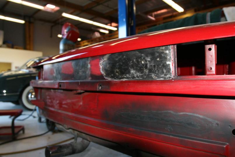

So some progress has been made...
First up are better pics of the deletion of the rear reflector holes and the antenna hole.
pete
