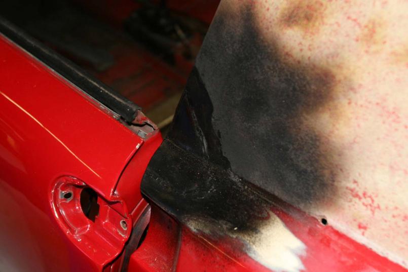

Next up... the targa bar and LR fender by the taillight.

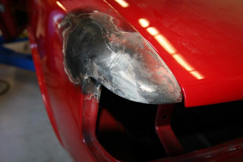

horizontally-opposed   So some progress has been made... First up are be...   Mar 6 2008, 12:09 AM
horizontally-opposed   Next up... the targa bar and LR fender by the tail...   Mar 6 2008, 12:11 AM
horizontally-opposed   Here's where things get interesting. After sc...   Mar 6 2008, 12:20 AM
horizontally-opposed   The two pinholes in the right front fender filled....   Mar 6 2008, 12:21 AM
horizontally-opposed   BUT, here's where the bummers begin. Same are...   Mar 6 2008, 12:24 AM
