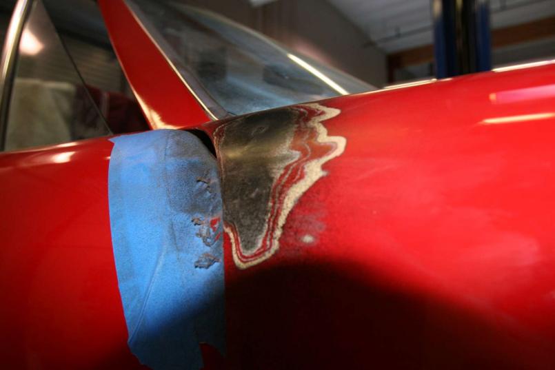

So I've decided to confront a few rust bubbles on my car, before painting it (the car looked great, but I never liked the wavy sides due to poor prep and no blocking).
If you can't stomach this first photo, please don't continue... (IMG:style_emoticons/default/biggrin.gif)

The two pinholes in the right front fender filled...

horizontally-opposed   Other sail panel.... Two pinholes + the factory h...   Feb 8 2008, 03:18 PM
horizontally-opposed   Two more pinholes in the right front fender, appar...   Feb 8 2008, 03:22 PM
horizontally-opposed   There's a wrong way to fill in the U.S. sidema...   Feb 8 2008, 03:24 PM
horizontally-opposed   And then there's a right way to do it... :wel...   Feb 8 2008, 03:25 PM
horizontally-opposed   Sorry for the sideways jpgs.... don't mean to ...   Feb 8 2008, 03:28 PM
horizontally-opposed   Last small enough photo for now... Taking the cha...   Feb 8 2008, 03:35 PM
