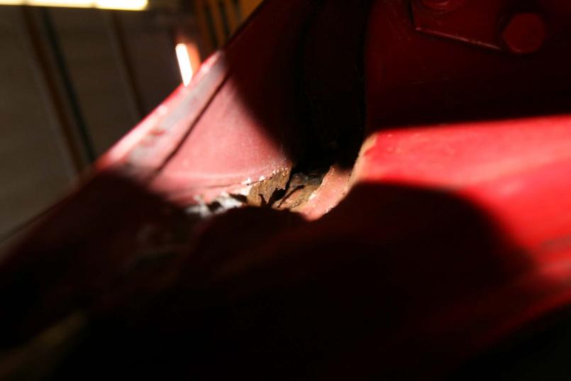

So I've decided to confront a few rust bubbles on my car, before painting it (the car looked great, but I never liked the wavy sides due to poor prep and no blocking).
If you can't stomach this first photo, please don't continue... (IMG:style_emoticons/default/biggrin.gif)

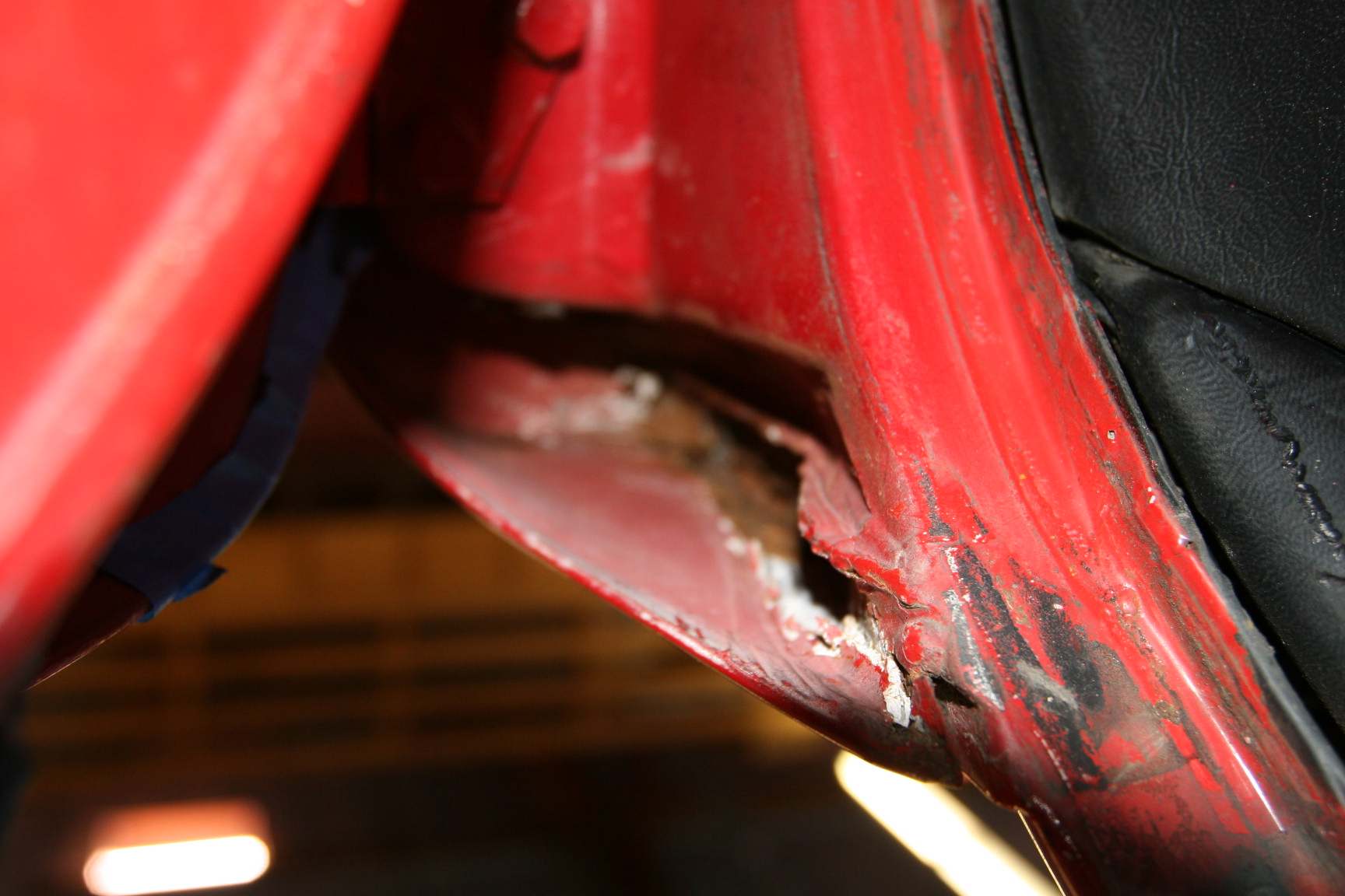

BUT, here's where the bummers begin.
Same area, as seen from the doorjamb. Sorry for the crappy angle. It's hard to shoot in there, and it will be even harder to weld in there.
Our plan at this poiint is to rid the area of the rust, gain access to the back of the metal that had the pinholes (easy because of the rust!) and then (probably) epoxy over the area once we've converted and encapsulated the rust.
It makes me cringe...
