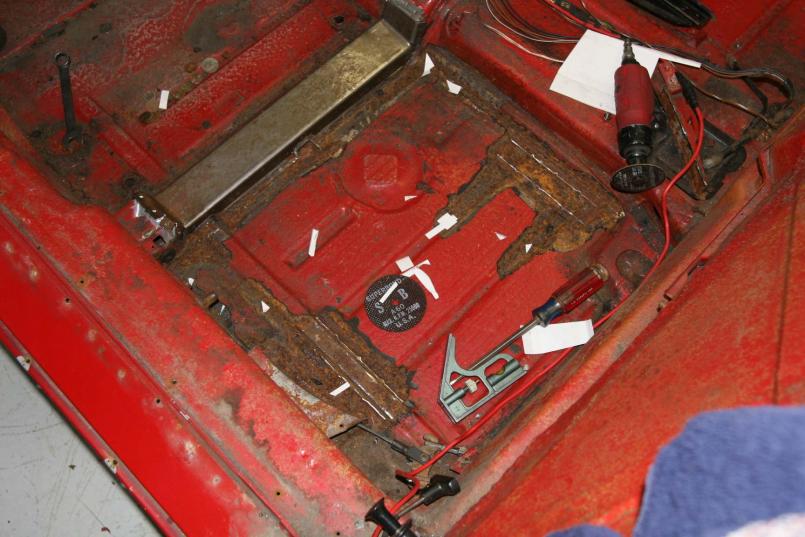

So I've decided to confront a few rust bubbles on my car, before painting it (the car looked great, but I never liked the wavy sides due to poor prep and no blocking).
If you can't stomach this first photo, please don't continue... (IMG:style_emoticons/default/biggrin.gif)

While we were in there syndrome set in, so I decided to have John weld in an Engman kit and lower my driver's seat, as he figured, much to my surprise, that we can get 0.75-1.00-inch out of the height. As I have a VERY long torso (most of my 6 feet, 3 inches), this was very appealing to me.
I decided to give the go-ahead.
And that's when the real fun with rust began....

horizontally-opposed   While we were in there syndrome set in, so I decid...   Mar 6 2008, 12:39 AM
dw914er   man that stuff is scary i just had a surface pai...   Mar 6 2008, 12:42 AM
horizontally-opposed   As you can see, as soon as the Bahia-painted tar w...   Mar 6 2008, 12:43 AM
rick 918-S   :popcorn: :wavebye:   Mar 6 2008, 12:48 AM
horizontally-opposed   Get up close to things, and you can see where the ...   Mar 6 2008, 12:49 AM
horizontally-opposed   The right side beam under the seat, which appears ...   Mar 6 2008, 12:52 AM
horizontally-opposed   Unfortunately, here's where I got more than a ...   Mar 6 2008, 01:02 AM
