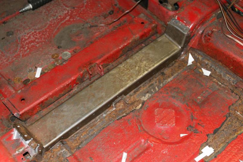

As you can see, as soon as the Bahia-painted tar was removed from the floorpan, and what you see was the stuff that came off easy, there was lots o' surface rust.
It makes my stomach turn...

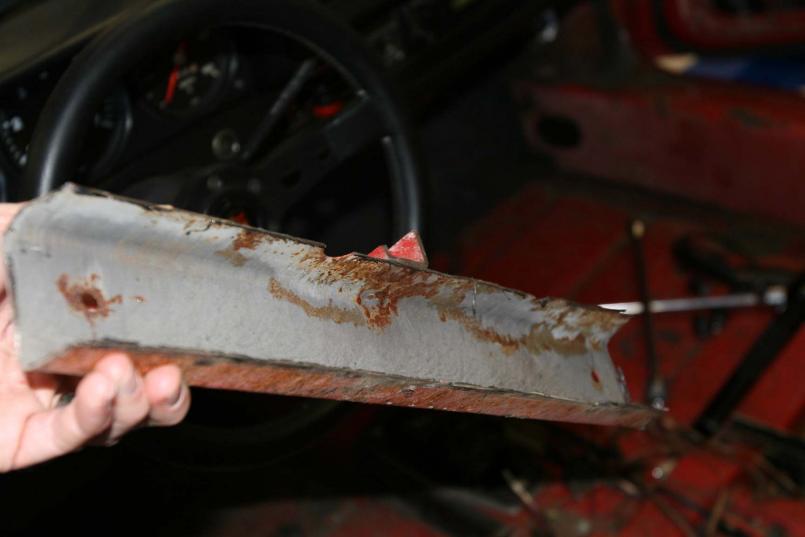

Then I removed the vinyl covering the various structural members under the seats and found them to be nice and rusty, too. A screwdriver went right through the forward beam under the driver's seat.
Made the decision to "unoriginalize" this piece in the name of getting my seat down REAL easy... (IMG:style_emoticons/default/sad.gif)

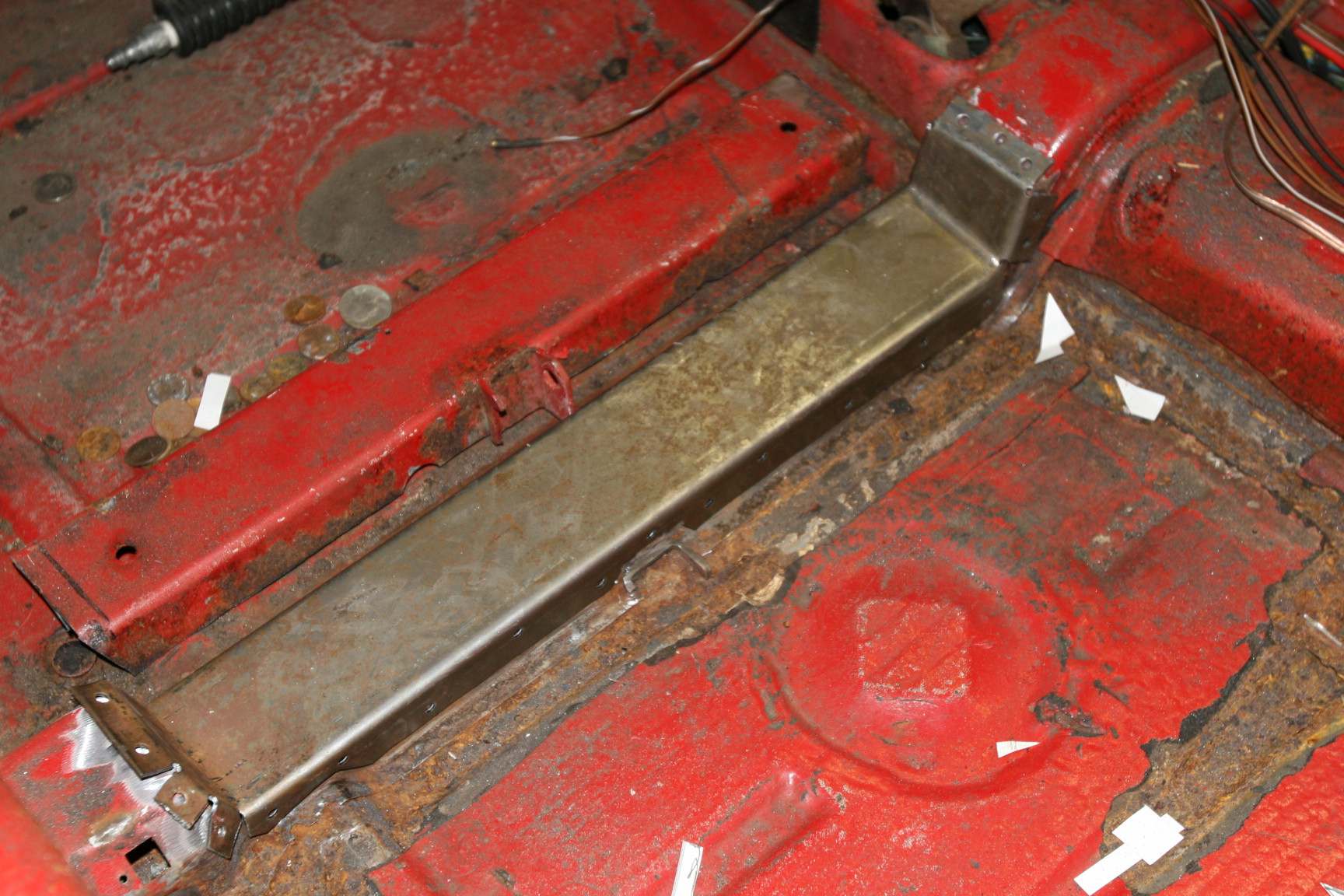

Second picture shows the beginning of the lowered boxed section.
