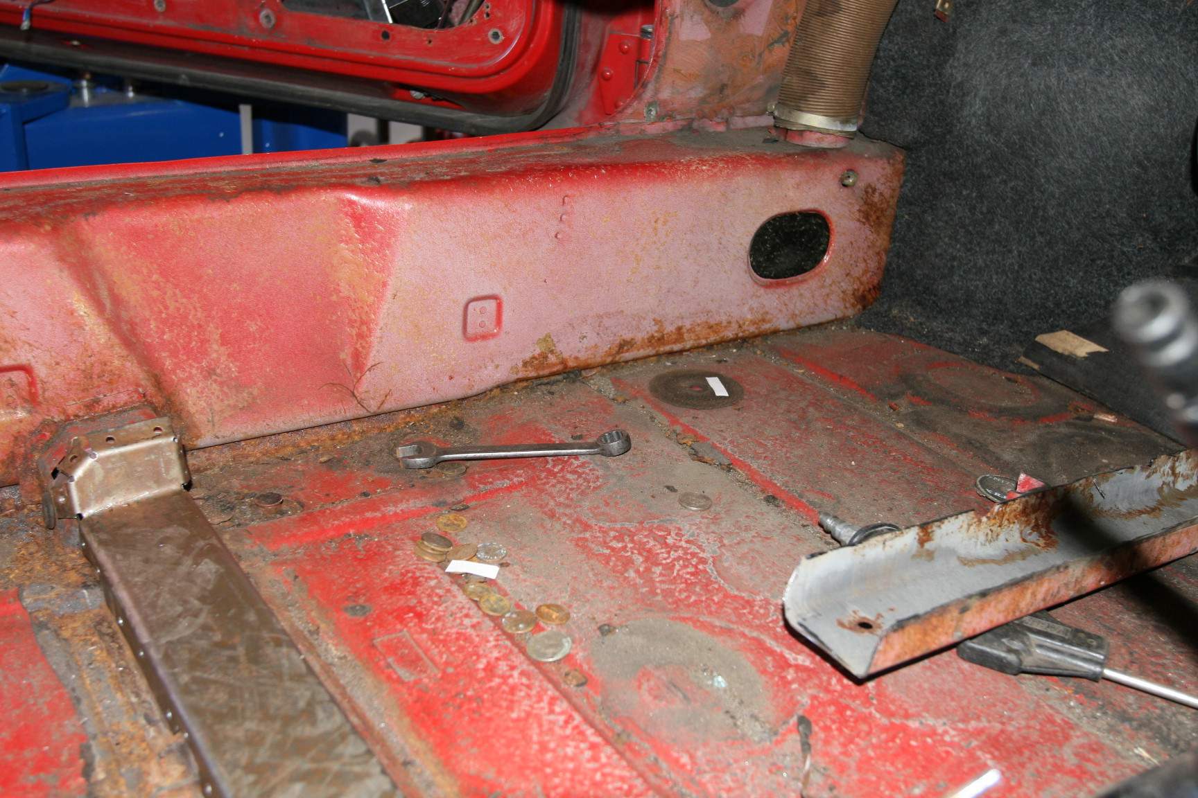

Get up close to things, and you can see where the rust is at work under the factory tar. A look down the front floorpan area indicates that only a little surface rust is having its fun along the lower longitudinal seam. We'll have to clear that up, too.
Oh yeah, you can see some of the change we've found here and there (there's been a LOT of it!!!!) and I thought I kept my floors pretty clean. Also found a cuff-link from prom in there....
