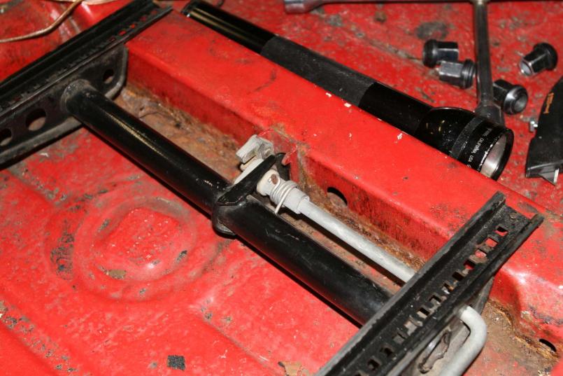

post Mar 6 2008, 12:52 AM
Posts: 3,456
Joined: 12-May 04
From: San Francisco
Member No.: 2,058
The right side beam under the seat, which appears to be much better than the left side (no perforation and seems strong), but will still need attention. Possibly a lot of attention...
So maybe passengers will get treated to a lower seating position, as well... (IMG:style_emoticons/default/wink.gif)

horizontally-opposed   The right side beam under the seat, which appears ...   Mar 6 2008, 12:52 AM
horizontally-opposed   Unfortunately, here's where I got more than a ...   Mar 6 2008, 01:02 AM
SirAndy   If you drive your 914 in the rain, this matters. ...   Mar 6 2008, 02:19 AM
Richard Casto   Unfortunately, here's where I got more than a...   Mar 6 2008, 08:07 AM
McMark   BTW, you saw you have The Crack®, right?   Mar 6 2008, 12:56 PM
horizontally-opposed   BTW, you saw you have The Crack®, right? Did n...   Mar 6 2008, 01:23 PM
John   BTW, you saw you have The Crack®, right? Did ...   Mar 6 2008, 09:50 PM
dw914er   gotta love old cars (any old car, doesnt exactly m...   Mar 6 2008, 03:53 PM
Krieger914   You can do it man! Hang in there for pete...   Mar 6 2008, 09:33 PM
Engman   BTW, you saw you have The Crack®, right? Did ...   Mar 6 2008, 09:46 PM
horizontally-opposed   Thanks, guys. Longitudinals look and sound good -...   Mar 6 2008, 10:43 PM
horizontally-opposed   Unfortunately, the left box didn't appear to h...   Mar 6 2008, 10:45 PM
