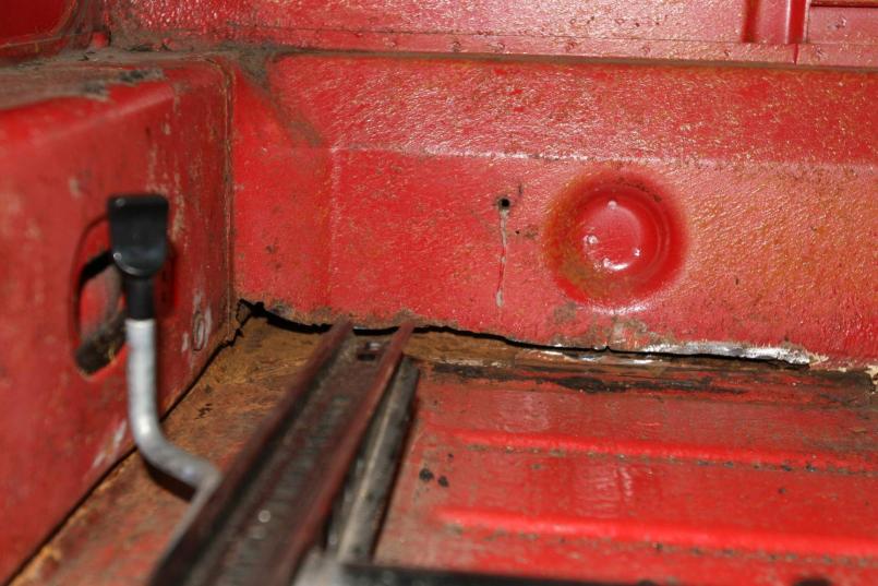

Longitudinals look and sound good -... Mar 6 2008, 10:43 PM
horizontally-opposed Unfortunately, the left box didn't appear to h... Mar 6 2008, 10:45 PM

horizontally-opposed Now for the not so fun: Apr 3 2008, 04:15 PM
horizontally-opposed "My" hell hole... Apr 3 2008, 04:16 PM
horizontally-opposed Another angle of hell... Apr 3 2008, 04:17 PM
horizontally-opposed Engman kit preparations. Very nice kit. Some holes... Apr 3 2008, 04:19 PM
horizontally-opposed Another... Apr 3 2008, 04:20 PM
horizontally-opposed And one more... of the seatbelt bolt hole. Both ha... Apr 3 2008, 04:28 PM
horizontally-opposed After much discussion, reviews of all the installa... Apr 3 2008, 04:29 PM
