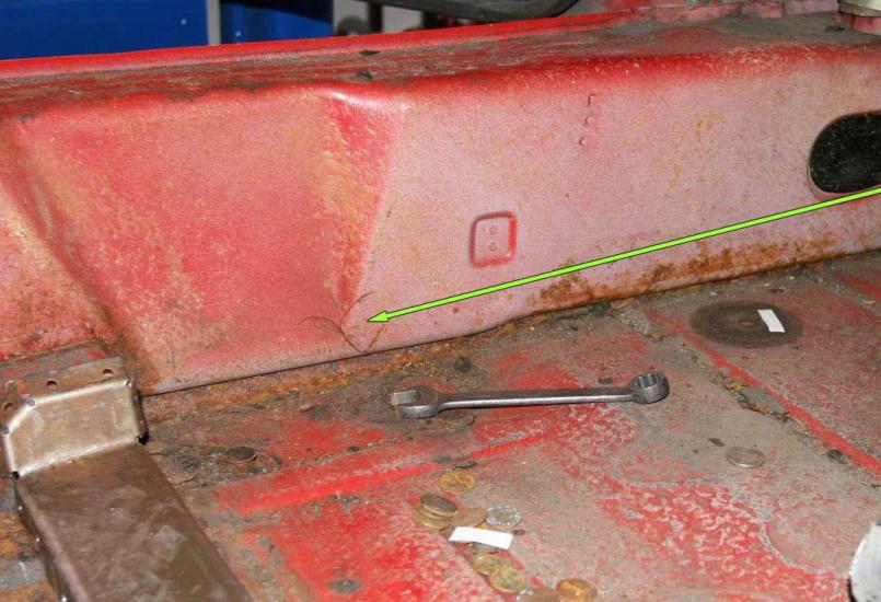

horizontally-opposed   Unfortunately, here's where I got more than a ...   Mar 6 2008, 01:02 AM
SirAndy   If you drive your 914 in the rain, this matters. ...   Mar 6 2008, 02:19 AM
Richard Casto   Unfortunately, here's where I got more than a...   Mar 6 2008, 08:07 AM
McMark   BTW, you saw you have The Crack®, right?   Mar 6 2008, 12:56 PM
horizontally-opposed   BTW, you saw you have The Crack®, right? Did n...   Mar 6 2008, 01:23 PM
John   BTW, you saw you have The Crack®, right? Did ...   Mar 6 2008, 09:50 PM

Engman   BTW, you saw you have The Crack®, right? Did ...   Mar 6 2008, 09:46 PM
horizontally-opposed   Thanks, guys. Longitudinals look and sound good -...   Mar 6 2008, 10:43 PM
horizontally-opposed   Unfortunately, the left box didn't appear to h...   Mar 6 2008, 10:45 PM
