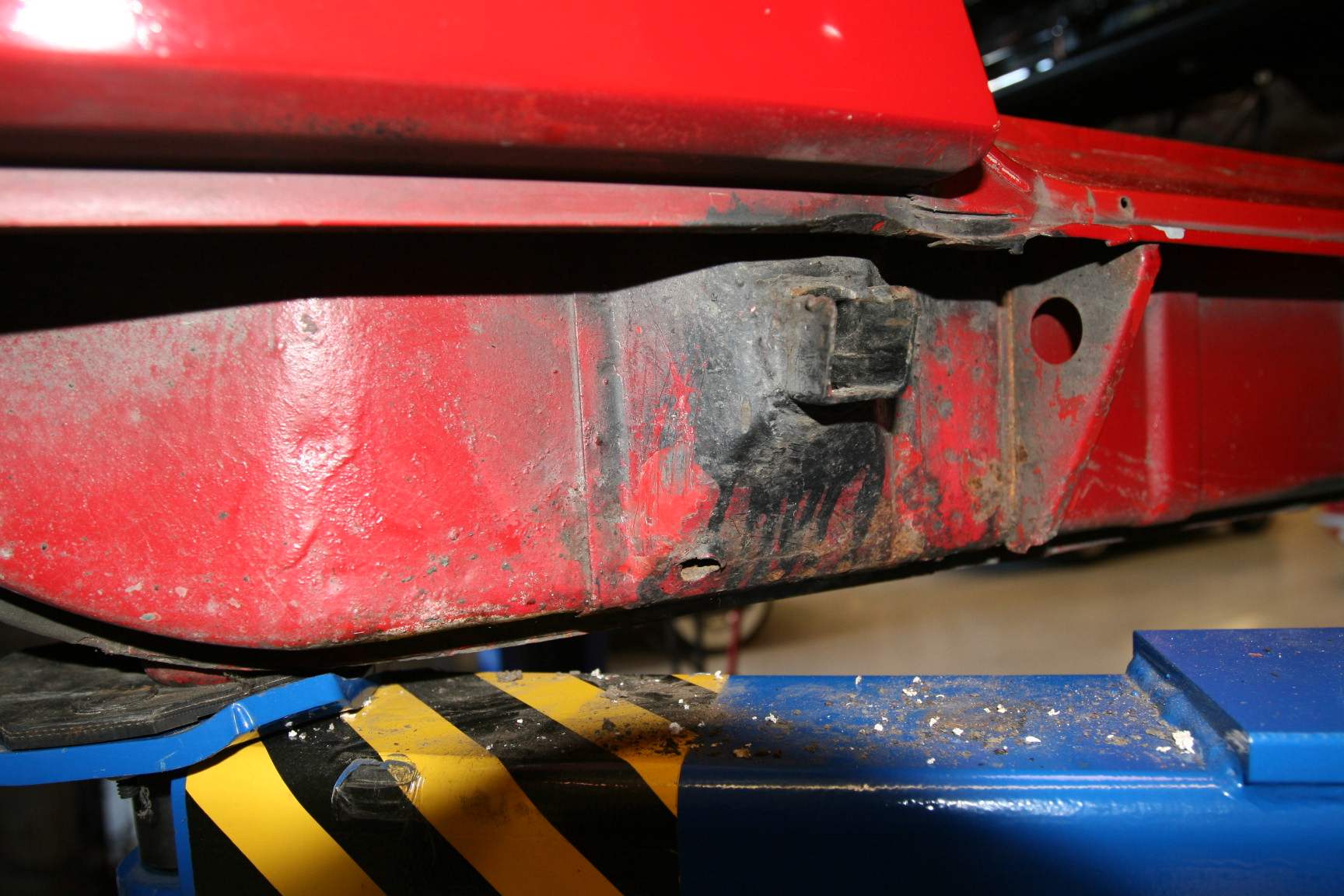

Thanks, guys.
Longitudinals look and sound good -- exception to this is the obvious damage from jack points that failed long ago. I've had the fix-it pieces for those for a long time, just never had them put in. And I've had the rockers off lots o' times over the year to clean out all the crud that accumulates along the sides of the car from the backroads of Northern California.
Well, this time the right jack "box" was fairly clear outside, and pretty clear when I cleaned out its drain hole. It also had good integrity.

horizontally-opposed   Thanks, guys. Longitudinals look and sound good -...   Mar 6 2008, 10:43 PM
horizontally-opposed   Unfortunately, the left box didn't appear to h...   Mar 6 2008, 10:45 PM
