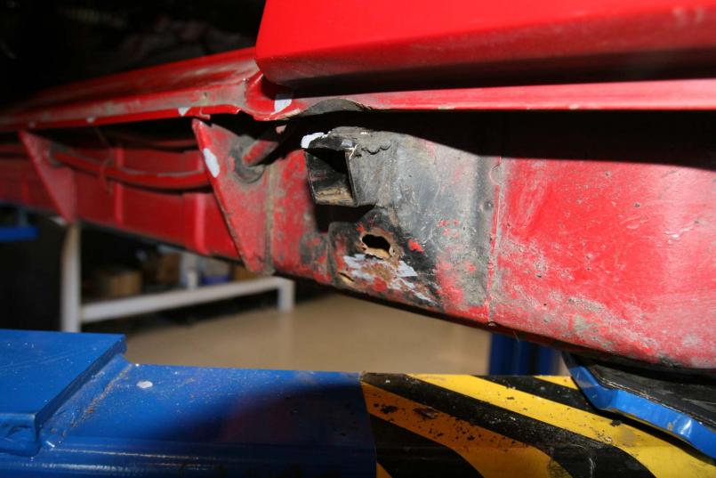

Unfortunately, the left box didn't appear to have a drain hole at all -- which didn't go with anything I remembered. Then I finally found it with the screwdriver.
Interestingly, the drain hole is towards the rear on the right side, where you'd think it would be, but it's towards the front on the driver's side, which isn't quite as smart (or maybe it doesn't matter...). Clearly, two stampings weren't in the cards.
Anyway, the left box was PACKED with dirt, and the predictable result was rust on the front face of the box. The good news is that the left longitudinal itself seems completely solid, and as nice as the one on the right. Phew!
I think I am going to go ahead and delete the jack-tube boxes entirely. This will give us a better look in there, and also rid the car of these now useless crud-catchers (which is what I will call these from now on) and I'm just not concerned with the concours aspect of this car. I'm much more interested in long-term preservation of utitlity...
