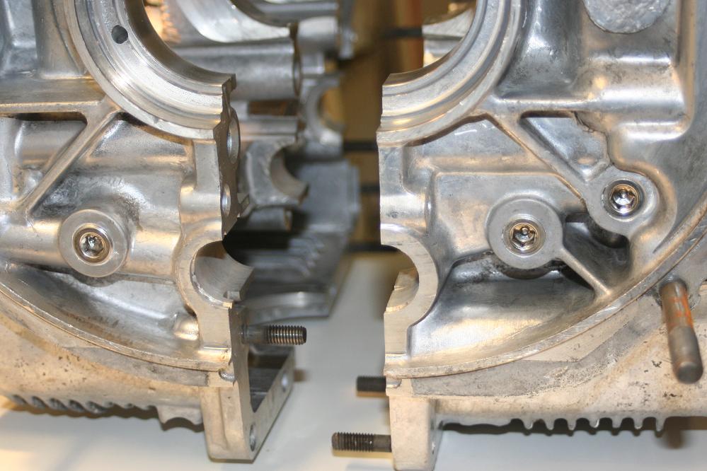

Current progress: Jake Raby rebuild DVD - Check. Tom Wilson's book - Check. I've split the case and and planning on bringing the case, crank, and rods for reconditioning to Dan Hall's Machine Shop here in Portland. After reading various forums, this appears to be the Type IV specialist in this area. Brand new Euro-spec P/C set - Check! (IMG:style_emoticons/default/smile.gif)
So now for my first question: Regarding the existing cylinder studs, Tom Wilson writes, "Unless you're installing case savers, don't remove the cylinder studs from the case. Doing so has no purpose, but does wear the potentially troublesome case threads, takes time, and stresses the studs" (p. 76).
In the assembly section, he states "If the cylinder studs were removed for some reason, install them now. Apply Permatex 3H to their threads to stop oil leaks" (p. 120).
I don't know the history of this case. I don't know if there was leakage at the head studs. Should I remove the studs, and reinstall with Permatex (after the case comes back from the machine shop, obviously) as a precaution to prevent potential leakage? Or should I just leave them be as is? Does it really put that much stress on the case to remove them, or is Wilson referring primarily to the Type I-III magnesium cases? I am leaning to toward remove and reinstall, as I strongly intend for this engine to be leak-free.

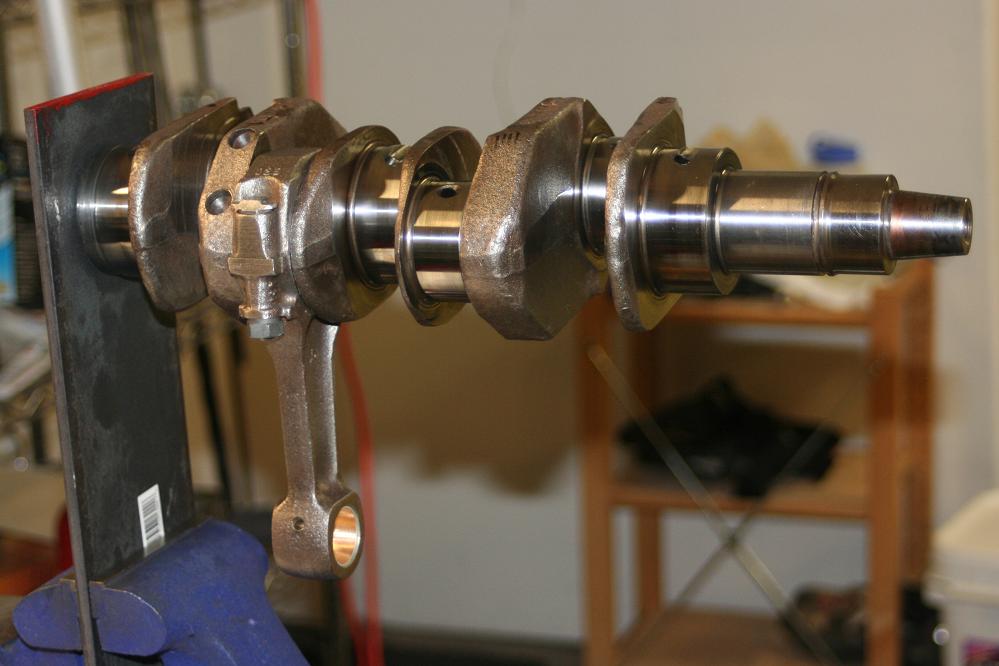

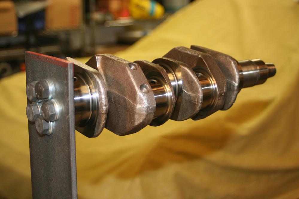

MrKona   Update on my engine build... The case, crank, and ...   Mar 19 2008, 12:10 AM
MrKona   More...   Mar 19 2008, 12:12 AM
MrKona   More...   Mar 19 2008, 12:15 AM
craig downs   Looks like your on the way to have a good running ...   Mar 19 2008, 12:38 AM
PBritain   what did you use to clean the case? looks incredi...   Mar 19 2008, 12:49 AM
MrKona   what did you use to clean the case? looks incred...   Mar 19 2008, 09:11 AM
Jake Raby   Lookin good! I like the cleaned threads on th...   Mar 19 2008, 09:15 AM
MrKona   Lookin good! I like the cleaned threads on t...   Mar 19 2008, 09:19 AM
Jake Raby   Excelent.. Stay away from shop rags filled with l...   Mar 19 2008, 09:29 AM
Vacca Rabite   That crank bracket is brilliant. I wish that I ha...   Mar 19 2008, 10:14 AM
6freak   That crank bracket is brilliant. I wish that I h...   May 29 2008, 01:27 PM
