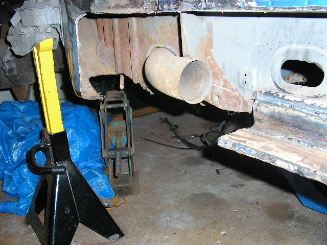

pjf   Here's a shot that gives you an idea of how mu...   Mar 22 2008, 05:48 PM
pjf   RE: Peter's Progress   Mar 22 2008, 05:49 PM

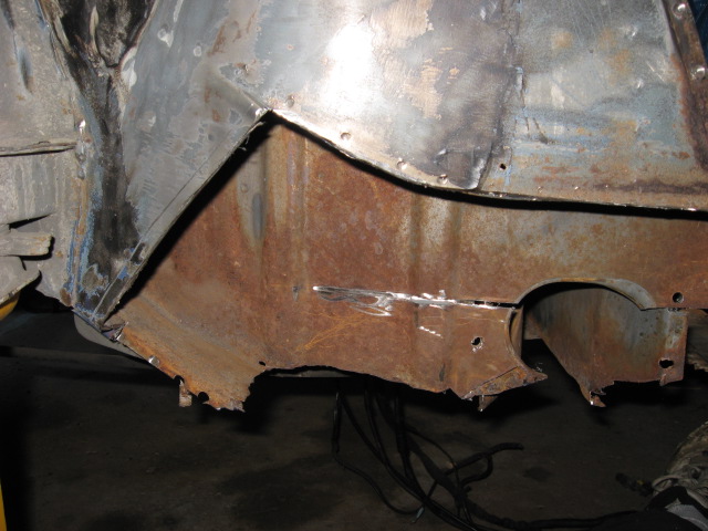

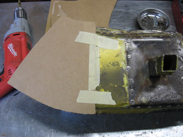

pjf   Now what? When I looked at the cost of the inner ...   Mar 22 2008, 06:03 PM
pjf   RE: Peter's Progress   Mar 22 2008, 06:03 PM

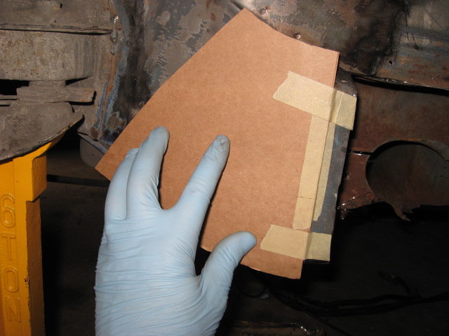

pjf   The tricky part of this was cutting the car and He...   Mar 22 2008, 06:08 PM
pjf   RE: Peter's Progress   Mar 22 2008, 06:09 PM
pjf   This worked for the right part but for the left in...   Mar 22 2008, 06:13 PM
pjf   RE: Peter's Progress   Mar 22 2008, 06:14 PM

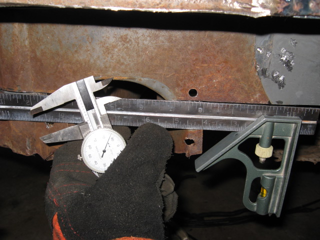

pjf   I next transferred the pattern piece to the car an...   Mar 22 2008, 06:47 PM

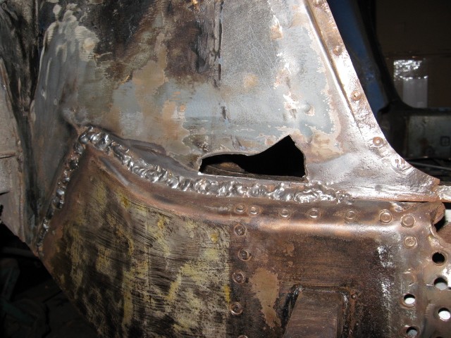

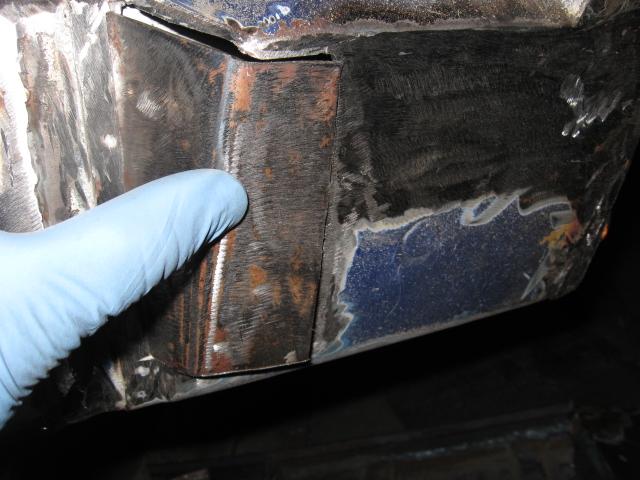

pjf   The welds were then completed and the reinforcing ...   Mar 22 2008, 07:12 PM
pjf   RE: Peter's Progress   Mar 22 2008, 07:12 PM
pjf   RE: Peter's Progress   Mar 22 2008, 07:14 PM
pjf   RE: Peter's Progress   Mar 22 2008, 07:15 PM

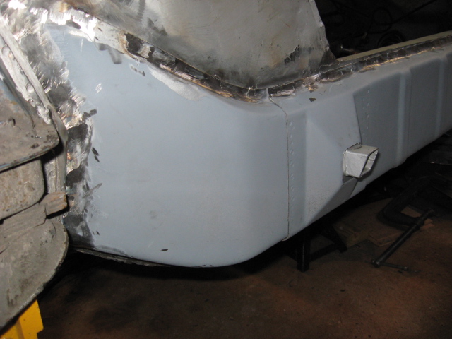

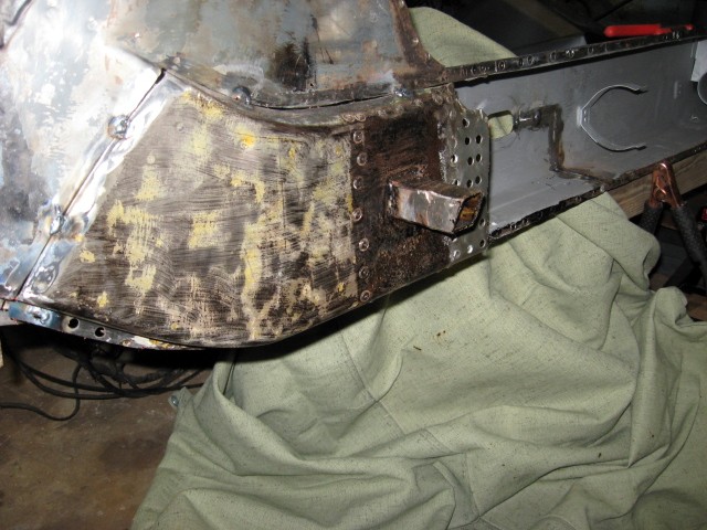

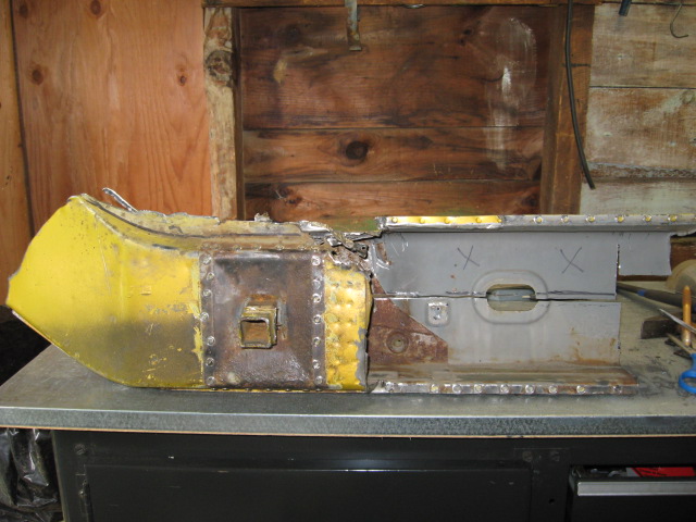

pjf   I was all ready to weld in the outer long piece fr...   Mar 22 2008, 07:23 PM
pjf   RE: Peter's Progress   Mar 22 2008, 07:24 PM
pjf   RE: Peter's Progress   Mar 22 2008, 07:25 PM

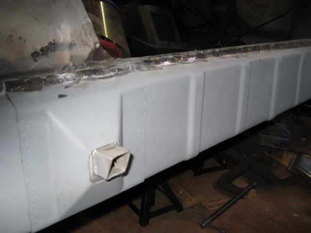

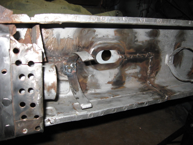

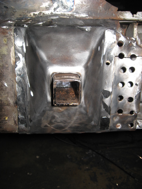

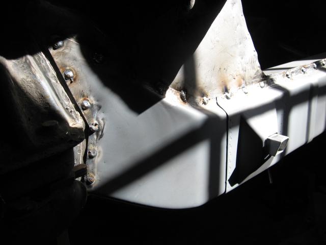

pjf   I had to repair the box at the front of the long a...   Mar 22 2008, 07:34 PM
pjf   RE: Peter's Progress   Mar 22 2008, 07:36 PM
pjf   RE: Peter's Progress   Mar 22 2008, 07:37 PM
pjf   RE: Peter's Progress   Mar 22 2008, 07:38 PM

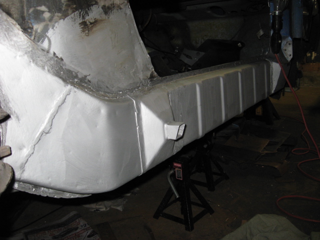

pjf   Lastly for added support (in case I blew a weld or...   Mar 22 2008, 07:43 PM
pjf   RE: Peter's Progress   Mar 22 2008, 07:44 PM
pjf   RE: Peter's Progress   Mar 22 2008, 07:45 PM
pjf   RE: Peter's Progress   Mar 22 2008, 07:46 PM
pjf   RE: Peter's Progress   Mar 22 2008, 07:47 PM

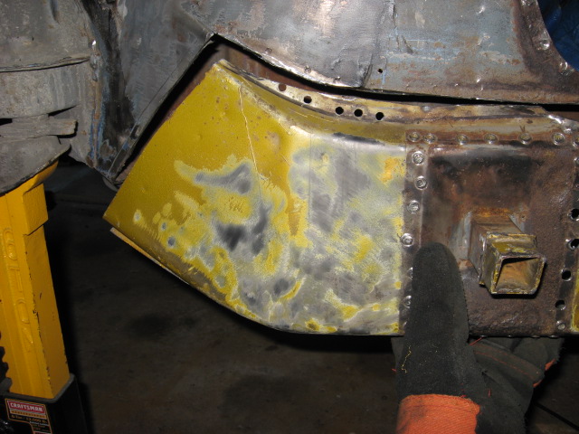

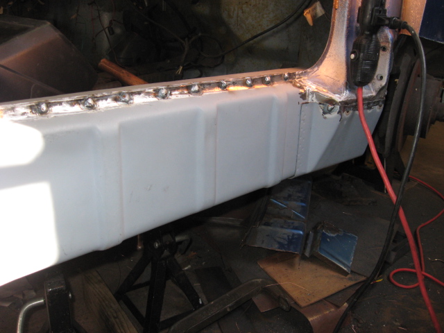

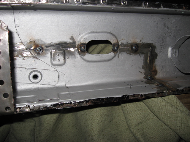

pjf   Tonight I started the left side long by drilling o...   Mar 28 2008, 08:58 PM
pjf   Then another epiphany hits me. I should be weldin...   Mar 28 2008, 09:12 PM
pjf   Here's the Engman piece laid up in place. I f...   Mar 28 2008, 09:18 PM
charliew   Paul good pictures, A couple of suggestions, if yo...   Mar 29 2008, 09:30 AM
pjf   I do have some burrs and have used them to elongat...   Mar 29 2008, 09:15 PM

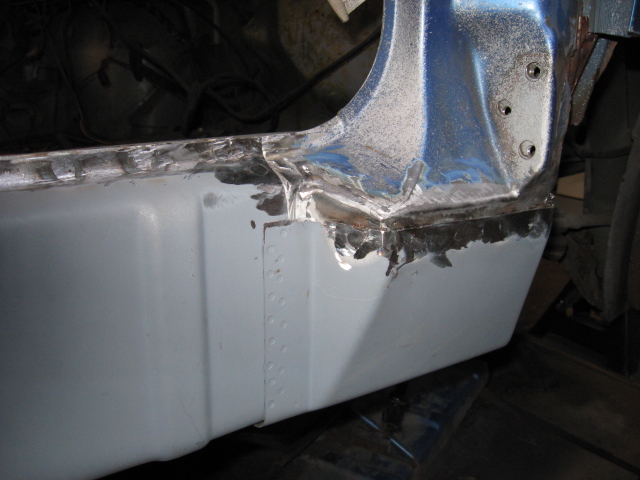

9146986   Can I suggest more welding practice? If your we...   Mar 30 2008, 09:32 AM
charliew   You can see the penetration on his previous post. ...   Mar 30 2008, 02:53 PM
pjf   Advice well taken. I have to admit looking back ...   Mar 30 2008, 04:37 PM
charliew   Peter you can try setting the heat for the new met...   Mar 30 2008, 10:04 PM
