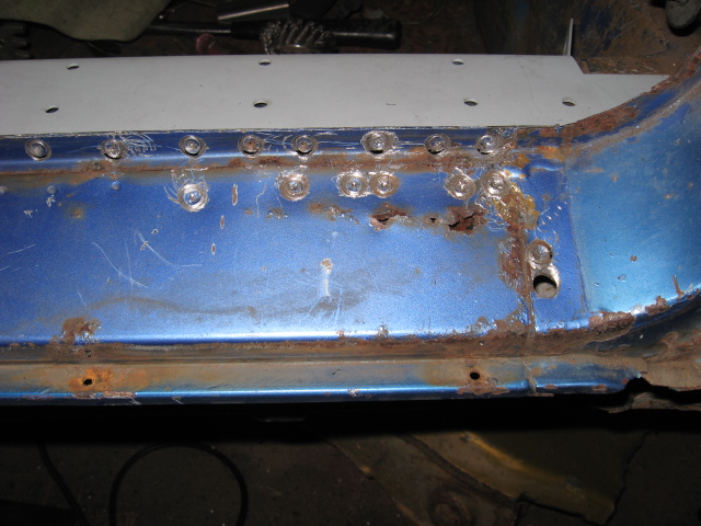

Tonight I started the left side long by drilling out the spot welds for the sill near the back where the long is rusted out. After 7 spot welds it occurs to me that I'm going to remove the whole outer long piece so I don't have to remove the sill. It can come off with the long piece. I hate it when I do unnecessary work. So next I started drilling out the spot welds of the top edge of the outer long as you can see.

pjf   Tonight I started the left side long by drilling o...   Mar 28 2008, 08:58 PM
