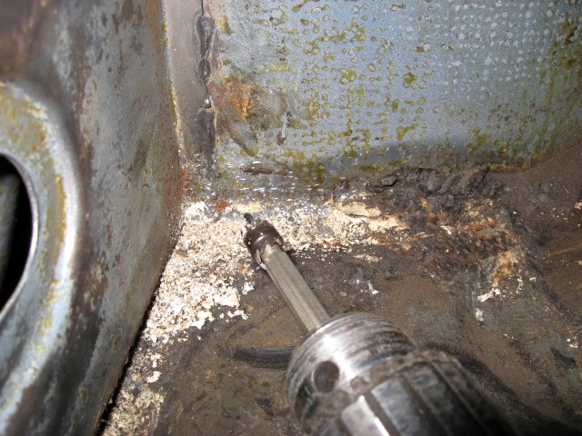

Then another epiphany hits me. I should be welding on the Engman inner reinforcement piece before I open up the long. That way it will be as strong as possible to resist any warping due to the welds. The hardest part of putting in one of these I've found is preparing the area to accept the piece. In particular there is seam sealer in the corners (especially the front bottom) that is really stubborn. It prevents the piece from mating up well with the inner long. I tried an air chisel, wood chisel and hammer, even pryed at it with a screwdriver. The stuff is just soft enough to stick in place. In a moment of desperation I grabbed my drill with the spot weld cutter still in it and voila! It ground out the crap in no time and was small enough to fully reach into the corner.
