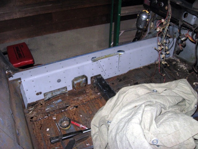

Here's the Engman piece laid up in place. I found that the front vertical edge of the Engman piece needed to be ground down a small amount to fit. I remember the other side was the same way. Here's the piece laid up. It just has to be pressed slightly to come up flush with the inner long. I next have to clean up things and mark and grind where the welds will hit the inner long.

pjf   Here's the Engman piece laid up in place. I f...   Mar 28 2008, 09:18 PM
charliew   Paul good pictures, A couple of suggestions, if yo...   Mar 29 2008, 09:30 AM
pjf   I do have some burrs and have used them to elongat...   Mar 29 2008, 09:15 PM
9146986   Can I suggest more welding practice? If your we...   Mar 30 2008, 09:32 AM
charliew   You can see the penetration on his previous post. ...   Mar 30 2008, 02:53 PM
pjf   Advice well taken. I have to admit looking back ...   Mar 30 2008, 04:37 PM
charliew   Peter you can try setting the heat for the new met...   Mar 30 2008, 10:04 PM
