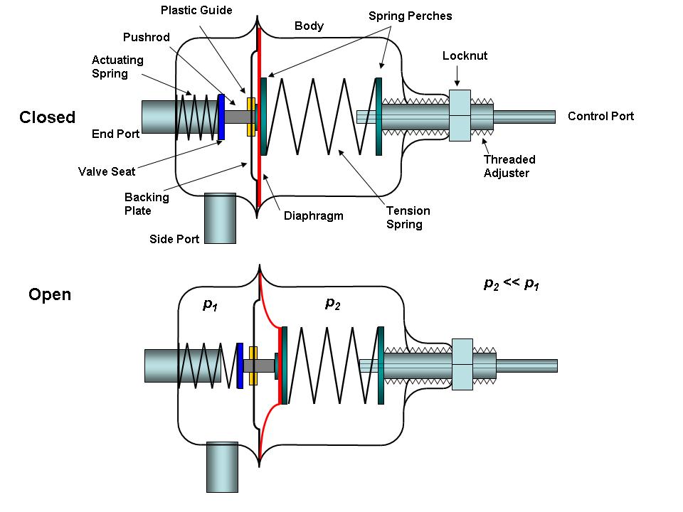

OK, here's what I think the guts of this thing look like, open and closed - if you want to see the picture more clearly, click on it to open it in a separate window:

QUOTE(pbanders @ Jan 26 2007, 04:54 PM) *
I think this diagram explains it all...Here's my take:
The Control Port is hooked up to the intake manifold (past the TB)
The End port is hooked up to the intake manifold (past the TB)
The Side port is hooked up to the air box or atmosphere.
P2 is completely sealed from P1
The End port is normally closed by some valve or plunger or whatever because of the spring pressure acted on it on the P2 side of the diaphragm.
When there is high manifold vacuum (overrun situation) the same amount of vacuum is applied to both the Control port and the End port (because they share the same source). Because the "valve" is sealing the End port (based on larger spring pressure), the End port is somewhat sealed or "plugged". Only when the manifold vacuum is high enough to overcome the spring pressure from the larger spring in the P2 area does the diaphragm deflect, thus opening the seal (valve, which is assisted by the smaller spring) from the End port, allowing fresh air to enter from side port to the manifold.
Extra air in the manifold during this overrun condition leans out the mixture and usually results in exhaust "popping." I think this would help to decrease exhaust emissions...
