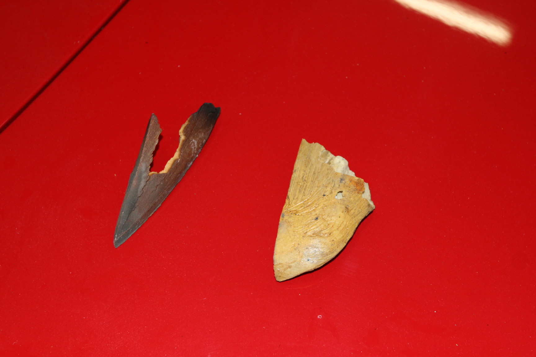

Moving along, here's what I took out of the voids above the taillights. The rust-darkened one from the left side where I had the rust bubble that inspired this odyssey, the light one is from the right side, which was still fine but on its way to a similar fate.
