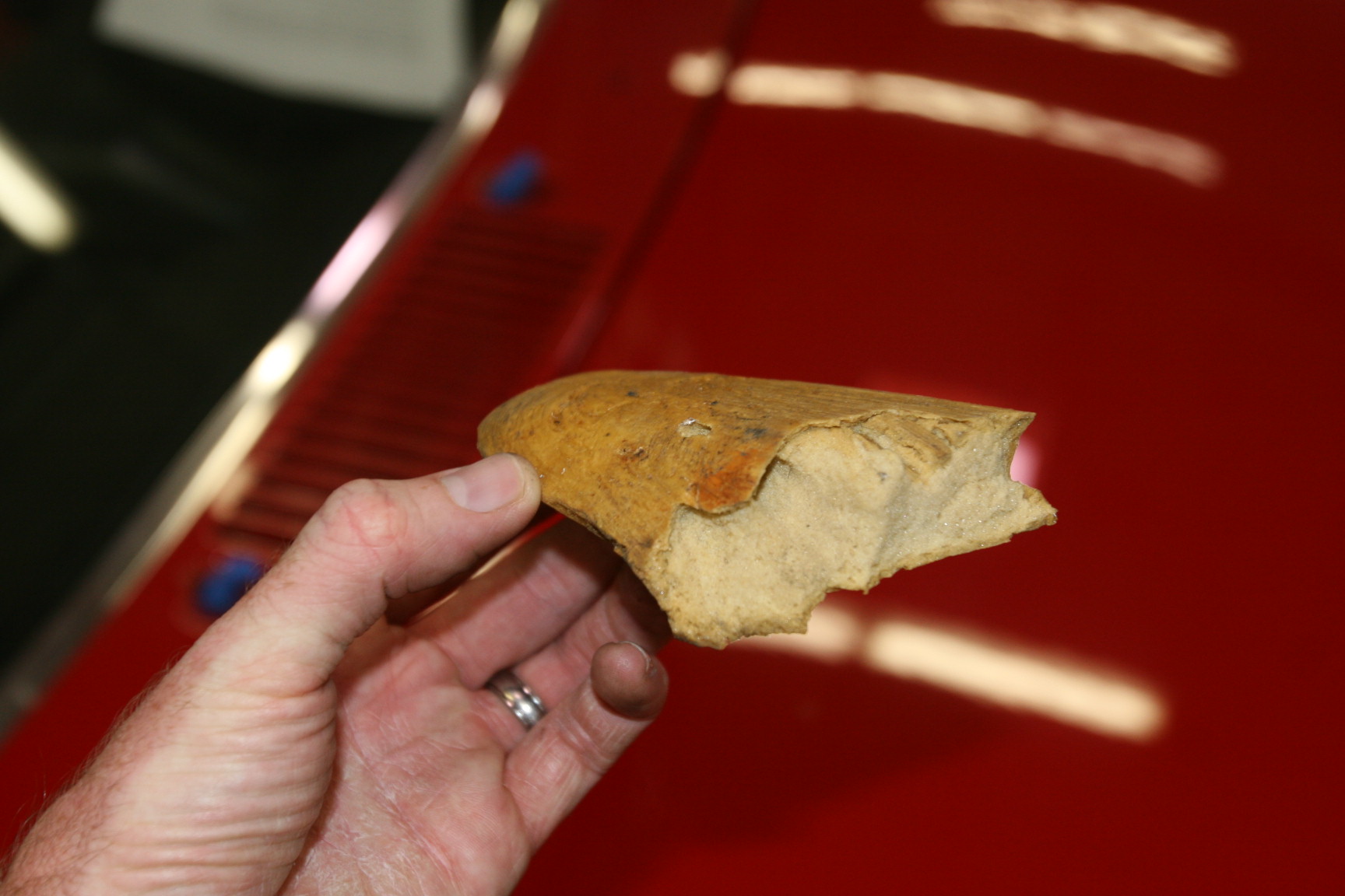

So I've decided to confront a few rust bubbles on my car, before painting it (the car looked great, but I never liked the wavy sides due to poor prep and no blocking).
If you can't stomach this first photo, please don't continue... (IMG:style_emoticons/default/biggrin.gif)
pete

SirAndy   This is the left rear corner, has been bothering ...   Feb 14 2008, 11:57 AM
John   you will have to remove *ALL* of the foam in th...   Feb 14 2008, 12:38 PM
