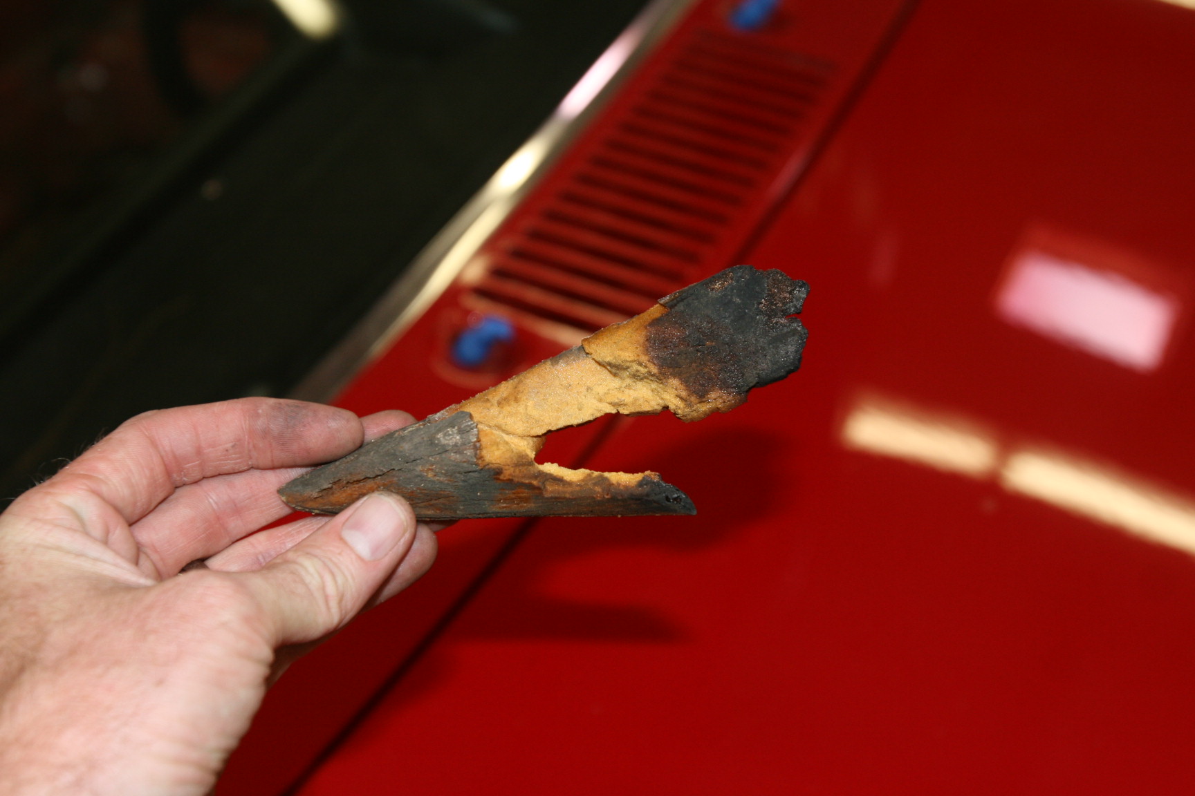

So I've decided to confront a few rust bubbles on my car, before painting it (the car looked great, but I never liked the wavy sides due to poor prep and no blocking).
If you can't stomach this first photo, please don't continue... (IMG:style_emoticons/default/biggrin.gif)

horizontally-opposed   Moving along, here's what I took out of the vo...   Apr 3 2008, 04:02 PM
horizontally-opposed   The good... (kinda)   Apr 3 2008, 04:03 PM
horizontally-opposed   And the ugly...   Apr 3 2008, 04:04 PM
