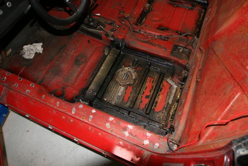

horizontally-opposed   Now for the not so fun:   Apr 3 2008, 04:15 PM
horizontally-opposed   "My" hell hole...   Apr 3 2008, 04:16 PM
horizontally-opposed   Another angle of hell...   Apr 3 2008, 04:17 PM

horizontally-opposed   Once the jack-post boxes were cut away, we found s...   Apr 7 2008, 02:02 PM
horizontally-opposed   and the left side...   Apr 7 2008, 02:02 PM
horizontally-opposed   So this is where the car stands today. Just a litt...   Apr 7 2008, 02:05 PM
