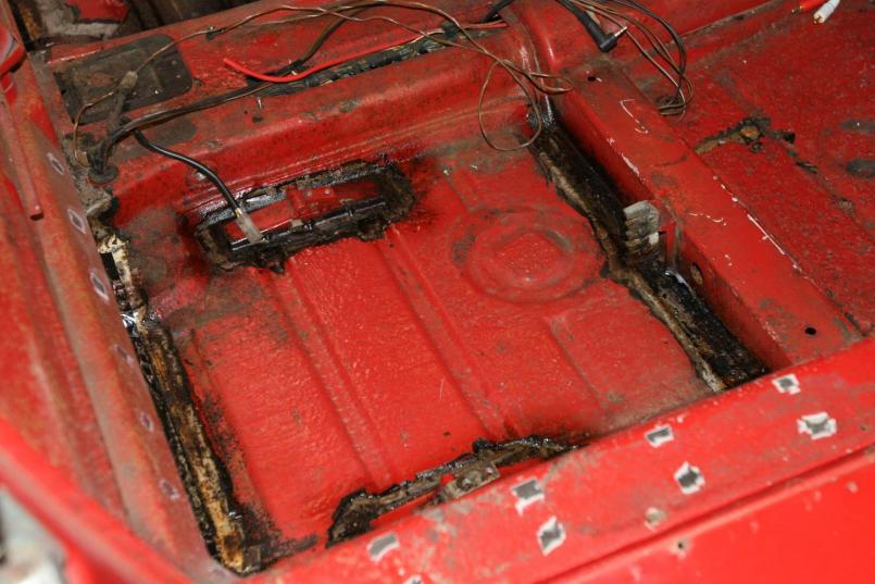

horizontally-opposed   Unfortunately, here's where I got more than a ...   Mar 6 2008, 01:02 AM
SirAndy   If you drive your 914 in the rain, this matters. ...   Mar 6 2008, 02:19 AM
Richard Casto   Unfortunately, here's where I got more than a...   Mar 6 2008, 08:07 AM

horizontally-opposed   Thanks, guys. Longitudinals look and sound good -...   Mar 6 2008, 10:43 PM
horizontally-opposed   Unfortunately, the left box didn't appear to h...   Mar 6 2008, 10:45 PM

horizontally-opposed   Now for the not so fun:   Apr 3 2008, 04:15 PM
horizontally-opposed   "My" hell hole...   Apr 3 2008, 04:16 PM
horizontally-opposed   Another angle of hell...   Apr 3 2008, 04:17 PM
