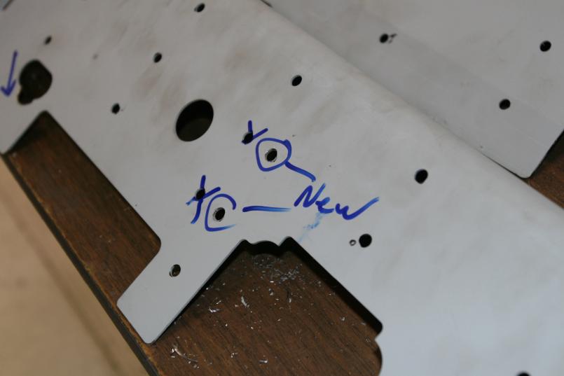

Engman kit preparations. Very nice kit. Some holes seemed to be in the wrong spots for my early '73...
Perhaps these pics will be helpful? (IMG:style_emoticons/default/confused24.gif)

horizontally-opposed   Engman kit preparations. Very nice kit. Some holes...   Apr 3 2008, 04:19 PM
horizontally-opposed   Another...   Apr 3 2008, 04:20 PM
horizontally-opposed   And one more... of the seatbelt bolt hole. Both ha...   Apr 3 2008, 04:28 PM
horizontally-opposed   After much discussion, reviews of all the installa...   Apr 3 2008, 04:29 PM
rick 918-S   Nice to hear about the progress Pete. :welder: :s...   Apr 3 2008, 10:18 PM
McMark   No doubt this thread is useful! Keep 'em ...   Apr 4 2008, 12:19 AM
Engman   Thank you for posting the pics! I always ask f...   Apr 4 2008, 11:48 AM
Root_Werks   I installed my kit last year. Went in like butter...   Apr 4 2008, 04:08 PM
horizontally-opposed   Mark, I too think your kit rocks! And I think...   Apr 4 2008, 10:42 PM
Engman   Thanks - but I am always on the lookout to improve...   Apr 4 2008, 11:52 PM
