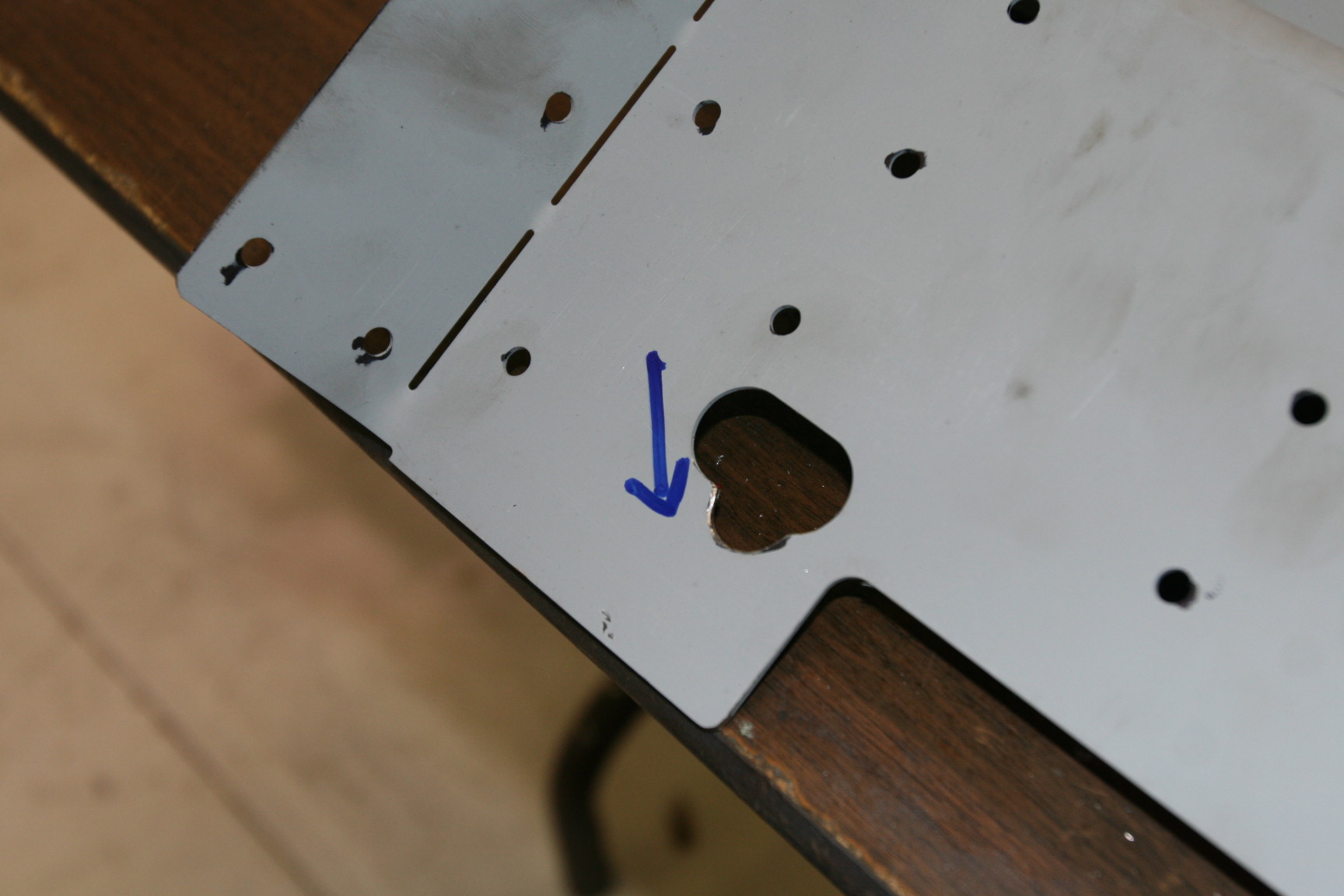

horizontally-opposed   Engman kit preparations. Very nice kit. Some holes...   Apr 3 2008, 04:19 PM
horizontally-opposed   Another...   Apr 3 2008, 04:20 PM
horizontally-opposed   And one more... of the seatbelt bolt hole. Both ha...   Apr 3 2008, 04:28 PM
horizontally-opposed   After much discussion, reviews of all the installa...   Apr 3 2008, 04:29 PM

Engman   Thank you for posting the pics! I always ask f...   Apr 4 2008, 11:48 AM
Root_Werks   I installed my kit last year. Went in like butter...   Apr 4 2008, 04:08 PM
horizontally-opposed   Mark, I too think your kit rocks! And I think...   Apr 4 2008, 10:42 PM
Engman   Thanks - but I am always on the lookout to improve...   Apr 4 2008, 11:52 PM
