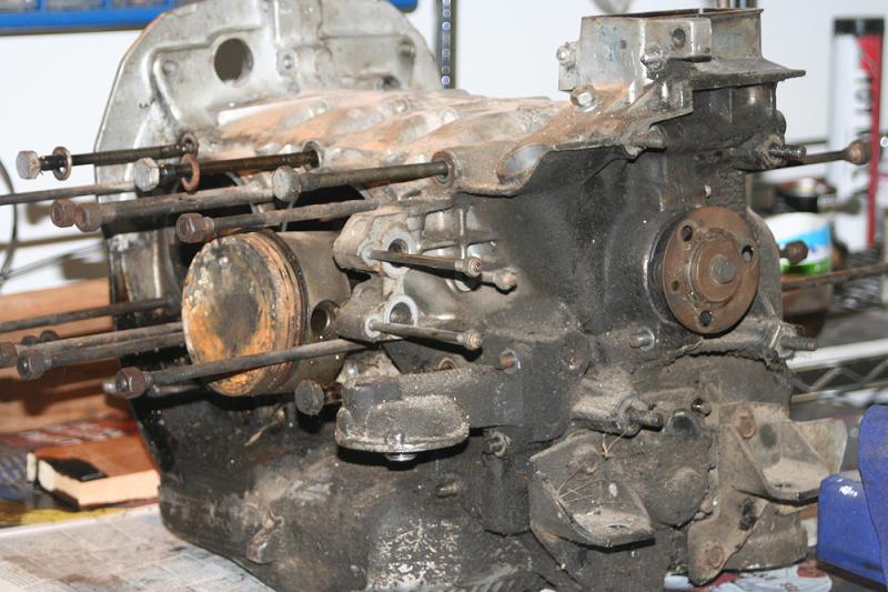

I talked about building up a 2.0 last winter, and now I'm finally going to do it. This is my first engine build, hence it'll be conservative and relatively stock. My only plan with the car is to have a nice, reliable, well constructed engine. I thought about a 2056, but I finally decided to stay with 94mm cylinders. I really don't want to have to tweak with FI or fiddle with cam selection right now. I've read that Jake's 9550 cam is excellent, but also that it produced dirty emissions. I'd like to keep this engine as clean as a type 4 can be. I'm also a little confused if Jake is even selling cams at the moment, so I've just decided to go with a stock grind.
My current engine is a PO rebuilt 1.8 with hydraulic lifters (with one that won't prime, sounds horrible, I can't wait to be done with them).

Current progress: Jake Raby rebuild DVD - Check. Tom Wilson's book - Check. I've split the case and and planning on bringing the case, crank, and rods for reconditioning to Dan Hall's Machine Shop here in Portland. After reading various forums, this appears to be the Type IV specialist in this area. Brand new Euro-spec P/C set - Check! (IMG:style_emoticons/default/smile.gif)
So now for my first question: Regarding the existing cylinder studs, Tom Wilson writes, "Unless you're installing case savers, don't remove the cylinder studs from the case. Doing so has no purpose, but does wear the potentially troublesome case threads, takes time, and stresses the studs" (p. 76).
In the assembly section, he states "If the cylinder studs were removed for some reason, install them now. Apply Permatex 3H to their threads to stop oil leaks" (p. 120).
I don't know the history of this case. I don't know if there was leakage at the head studs. Should I remove the studs, and reinstall with Permatex (after the case comes back from the machine shop, obviously) as a precaution to prevent potential leakage? Or should I just leave them be as is? Does it really put that much stress on the case to remove them, or is Wilson referring primarily to the Type I-III magnesium cases? I am leaning to toward remove and reinstall, as I strongly intend for this engine to be leak-free.

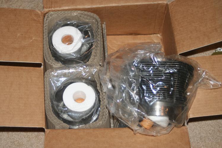

MrKona   Small progress update. Parts - I'm buying a r...   Dec 24 2007, 05:57 PM
hydroliftin   I plan on sticking with my already acquired 94mm...   Dec 24 2007, 07:04 PM
MrKona   I plan on sticking with my already acquired 94m...   Dec 24 2007, 07:32 PM
