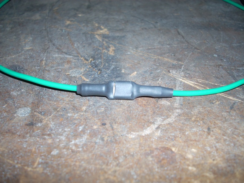

I use a double crimp connector. One crimp connects the wire to the spade, the other crimp grabs the insulation to keep it from working loose. Then I heat shrink everything. I LOATHE the blue/yellow/red plastic connectors. Nothing says "HACK JOB!" like those pieces of crap. (IMG:style_emoticons/default/barf.gif)
Sorry for the crap picture. (IMG:style_emoticons/default/dry.gif)

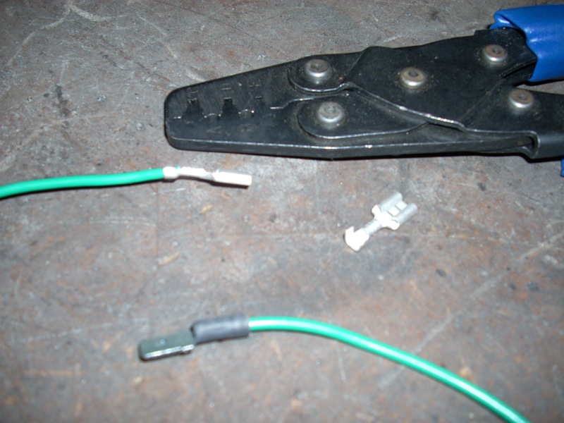

McMark   I had to make another connector, so I took better ...   Apr 5 2008, 02:18 PM
jkeyzer   Nice! I am guilty of using the cheesy red/blu...   Apr 5 2008, 02:56 PM
