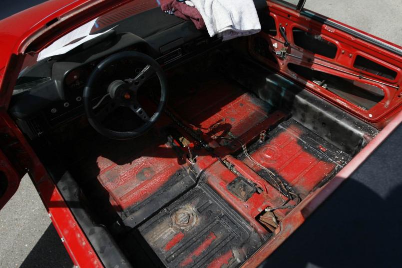

horizontally-opposed   Moving along, here's what I took out of the vo...   Apr 3 2008, 04:02 PM
horizontally-opposed   The good... (kinda)   Apr 3 2008, 04:03 PM
horizontally-opposed   And the ugly...   Apr 3 2008, 04:04 PM
horizontally-opposed   Now, onto the interior...   Apr 3 2008, 04:06 PM
horizontally-opposed   closer in on the lowered driver's seat...   Apr 3 2008, 04:07 PM
horizontally-opposed   And closer still...   Apr 3 2008, 04:08 PM
horizontally-opposed   another angle... Bolted the GTS seat in after thi...   Apr 3 2008, 04:12 PM
horizontally-opposed   Now for the not so fun:   Apr 3 2008, 04:15 PM
horizontally-opposed   "My" hell hole...   Apr 3 2008, 04:16 PM
horizontally-opposed   Another angle of hell...   Apr 3 2008, 04:17 PM
horizontally-opposed   Engman kit preparations. Very nice kit. Some holes...   Apr 3 2008, 04:19 PM
horizontally-opposed   Another...   Apr 3 2008, 04:20 PM
horizontally-opposed   And one more... of the seatbelt bolt hole. Both ha...   Apr 3 2008, 04:28 PM
horizontally-opposed   After much discussion, reviews of all the installa...   Apr 3 2008, 04:29 PM
