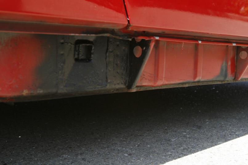

Once the jack-post boxes were cut away, we found solid metal. But rust was at work. I decided to eliminate the boxes, as they failed long ago in a scary way and always seems like the "catch" point for dirt and moisture.
I carry a scissors jack these days....

horizontally-opposed   Kit in place...   Apr 7 2008, 01:55 PM
horizontally-opposed   closer...   Apr 7 2008, 01:58 PM
horizontally-opposed   Bulk of sills are still Bahia thanks to the alumin...   Apr 7 2008, 01:59 PM
horizontally-opposed   Once the jack-post boxes were cut away, we found s...   Apr 7 2008, 02:02 PM
horizontally-opposed   and the left side...   Apr 7 2008, 02:02 PM
horizontally-opposed   So this is where the car stands today. Just a litt...   Apr 7 2008, 02:05 PM
