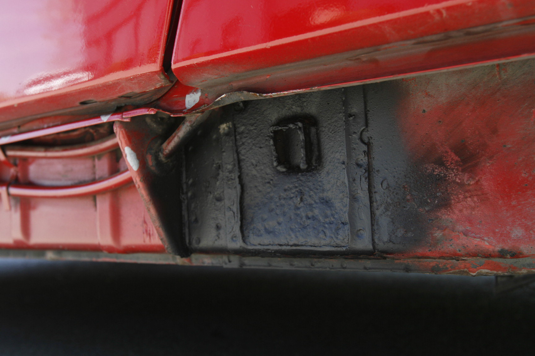

horizontally-opposed The right side beam under the seat, which appears ... Mar 6 2008, 12:52 AM
horizontally-opposed Unfortunately, here's where I got more than a ... Mar 6 2008, 01:02 AM

horizontally-opposed Once the jack-post boxes were cut away, we found s... Apr 7 2008, 02:02 PM
