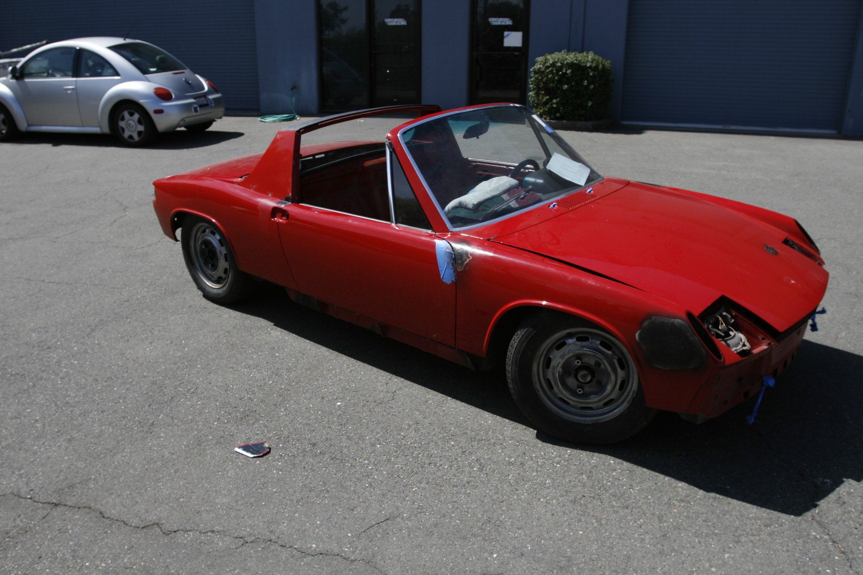

horizontally-opposed   So this is where the car stands today. Just a litt...   Apr 7 2008, 02:05 PM
horizontally-opposed   And from the rear. Man those 165s on steelies are ...   Apr 7 2008, 02:06 PM
