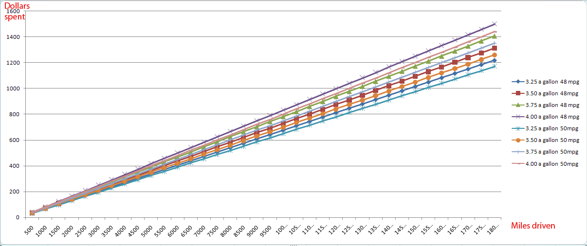

That means making an engine that needs no special support equipment! No 2K headers, no external oil coolers or DTM systems, cost effective ignition and induction.
Its a big picture and I'll tell you now that programmable FI would not be cost effective on this one, it would cost 3K to get 2 extra MPG. do the math.
OK, I got a chart going with that math.

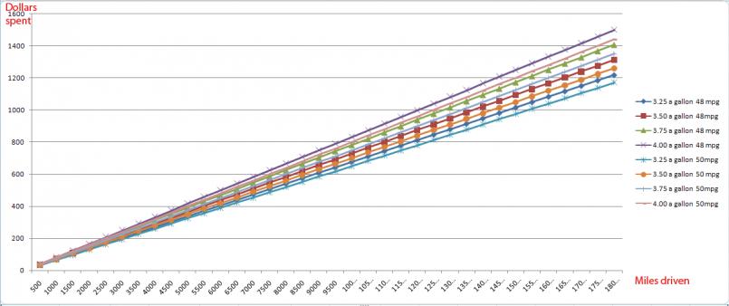

RJMII   Ok I could not resist I went ahead and did the m...   Apr 10 2008, 05:49 PM
