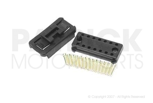

I went to put the wiring harness connector back on the relay board today and it broke. I know you can un-strap them and replace the plastic part. Does anyone know if you can buy them new?
I just don’t know why a 36 year old plastic connector like that would break? (IMG:style_emoticons/default/smile.gif) |

I went to put the wiring harness connector back on the relay board today and it broke. I know you can un-strap them and replace the plastic part. Does anyone know if you can buy them new? I just don’t know why a 36 year old plastic connector like that would break? (IMG:style_emoticons/default/smile.gif) 14 pin ! http://www.patrickmotorsports.com/part/144/ Attached image(s)

swl which connector Chris? 14, 12 or 4? Jeff Bowlesby... May 4 2008, 07:18 AM

McMark This might be something good for Bruce (GWN7) to m... May 4 2008, 04:13 PM
ClayPerrine The 14 pin connectors are a standard 911 part and ... May 4 2008, 05:20 PM
chris914 Would you happen to know the part number?
I looke... May 4 2008, 06:44 PM
ClayPerrine
I look... May 4 2008, 09:42 PM
