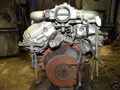

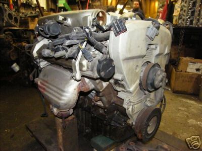

The Ford SHO was a taurus with a high performance motor built by Yamaha. One of the most beautiful intakes ever on a production car. It is reported to be capable of reving to 10,000 rpms without breaking a sweat. Keeping the belts on would probably be a problem if you had the guts to try (IMG:style_emoticons/default/smile.gif)
Here's a couple pics to show the height. I doubt a dry sump pan would be enough. It looks like the crankshaft centerline to the top of the intake is too far to fit in a 914 engine bay.

Crazyhippy   Been tried, It is WAY tall (holes in the decklid, ...   May 7 2008, 10:08 AM
