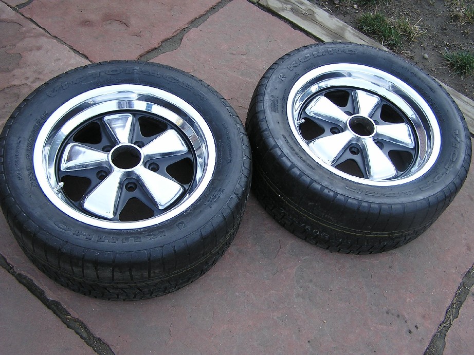

My Fuchs just got dropped off and I bought the Mothers Power Ball and Mothers Power Metal ( Aluminium ) Polish. Going to power wash the rims first then I thought I would check with club members before I did anything else just in case there is a chance I could do more harm than good. I read in a previous post somewhere that a fine grit sandpaper had been used, I am scared shitless to do that for some reason. All comments appreciated even the smart ass ones!

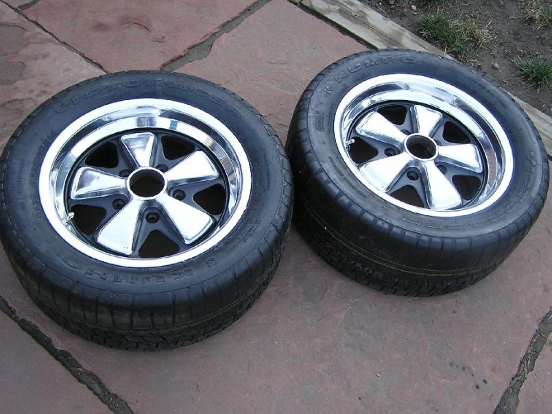

the above steps combined are my process too
1) usually 2 coats of air craft stripper
3) coats of easy off
4) sand paper for a couple of hours for nicks and scuffs
5) polishing wheels for a couple of hours for shine
6) 2 hours hand taping
7) aluminum self etching primer
9) epoxy type wheel paint in the appropriate shade
viola... about 6 hours per a wheel and you have this
I've got about 15 of these done so far:
