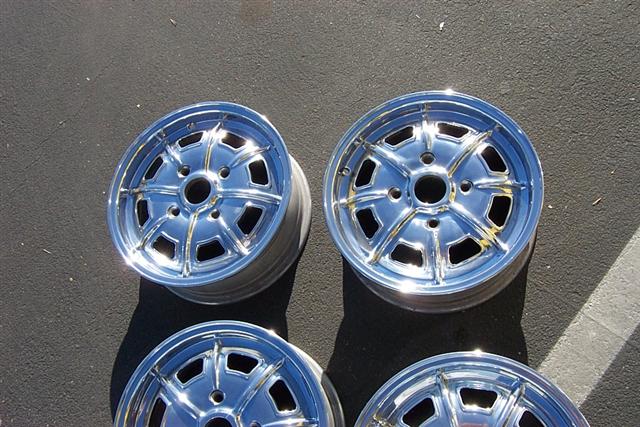

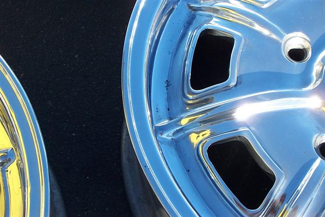

sticking with the pedrini's for a moment
I agree the sand cast is less desirable for polishing
I have a set that look great from 5 + feet but would need a lot of holes filled grinded and more polish to be perfect
so if you have the time do it
