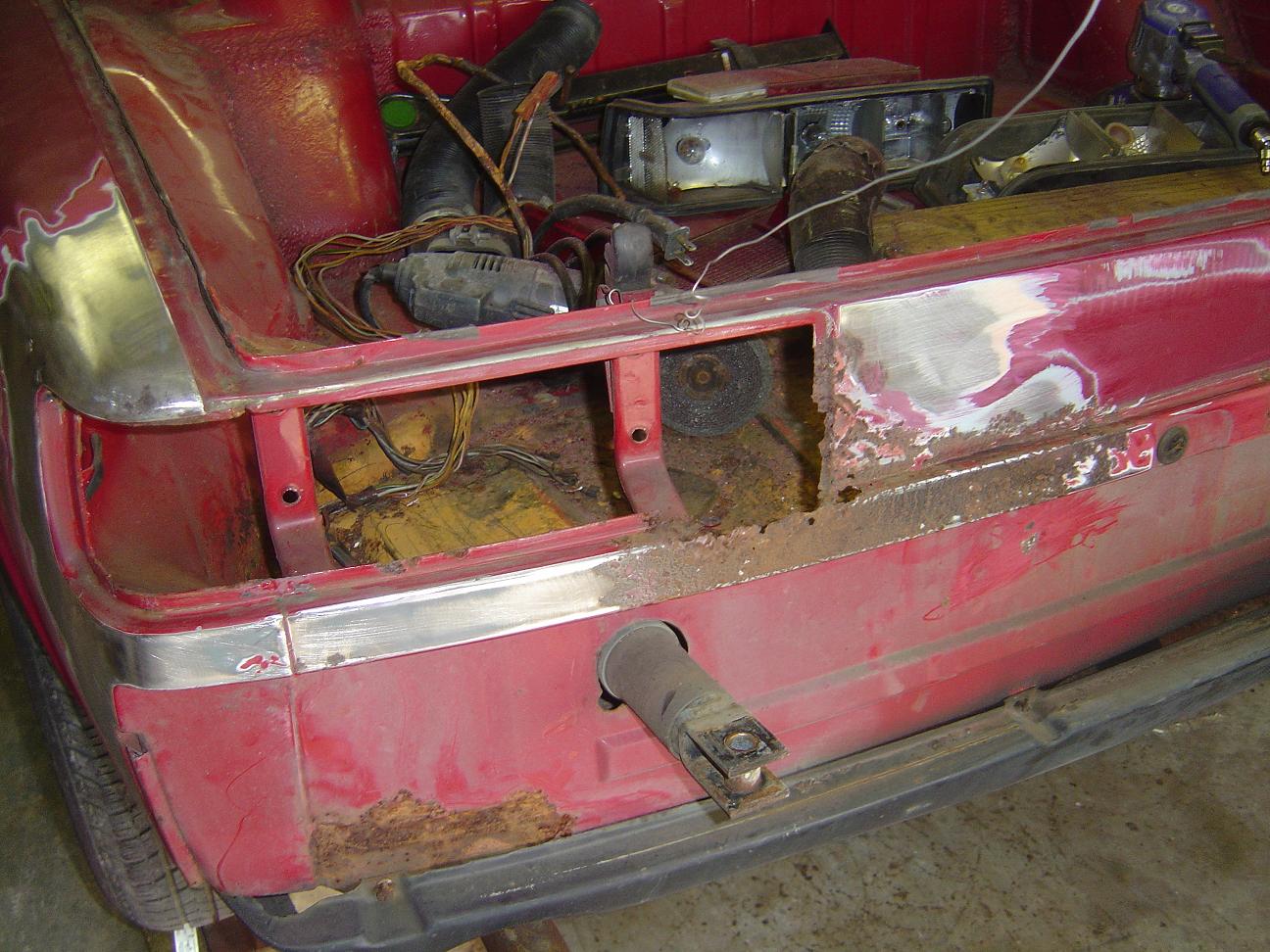

I just got my 914 in today to find much more rust than the car was said to have. Most if very minor and I can repair without a problem. The one spot that has me worried is the section located in the spot in this picture. There is a nice 3" hole there and while looking up in the whole I see some custy rust on the wall between the engine and seats but its not that bad. Other than that it just looks like the rust is in the floor. The battery tray was rusted up bad but to be honest the area under the battery does not look bad at all. I guess this is the Hell hole that everyone is talking about but mine is not near as bad as the others I have seen. Maybe Im missing something but It looks like I can clean up all the rust inside the whole, treat it and then weld a patch on the floor. What do you think?

MikeHall   Is the engine shelf needed on these cars? The pass...   May 15 2008, 12:57 PM
Todd Enlund   Is the engine shelf needed on these cars? The pas...   May 15 2008, 02:12 PM

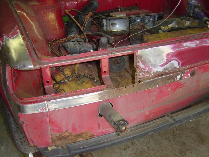

MikeHall   Here are a few pictures of the rust. Mike   May 15 2008, 05:11 PM
MikeHall   Rust.   May 15 2008, 05:12 PM
MikeHall   More rust.   May 15 2008, 05:13 PM

MikeHall   I have a good tail pan found so that should be eas...   May 16 2008, 07:30 AM
Vacca Rabite   Whats the best Por or Rust bullet? Rust bullet wo...   May 16 2008, 07:58 AM
Todd Enlund   I have a good tail pan found so that should be ea...   May 16 2008, 11:21 AM
MikeHall   You very well may be right. The only real problem ...   May 16 2008, 10:36 AM
