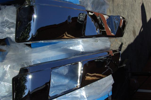

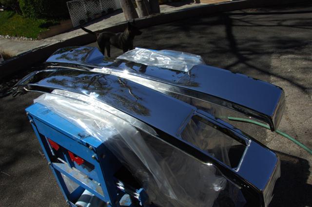

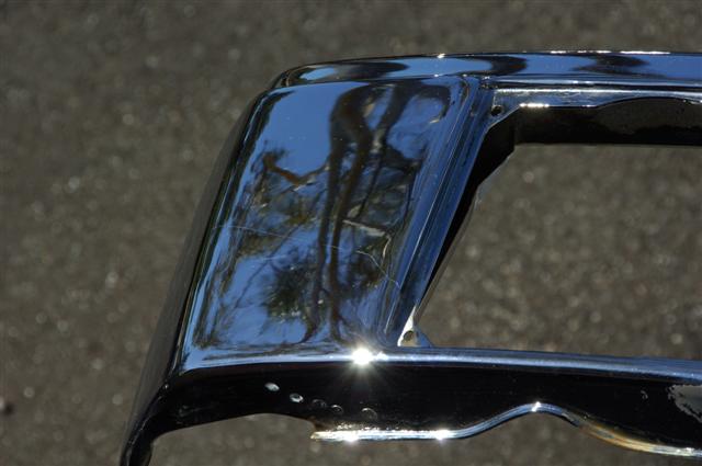

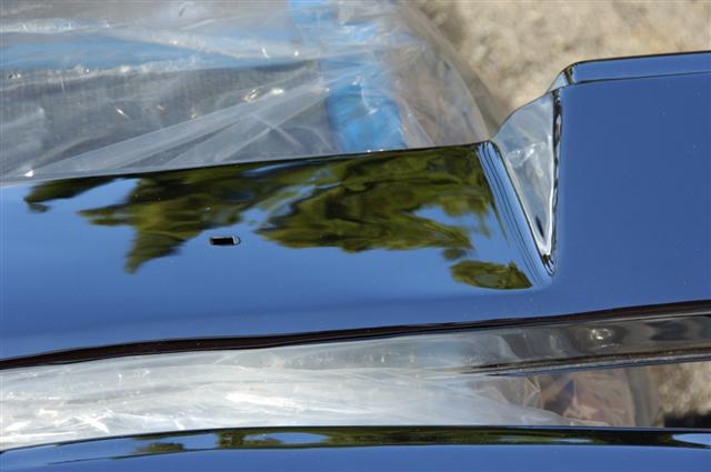

porsche914gt   Couple of pics.   Jul 11 2008, 11:11 AM
