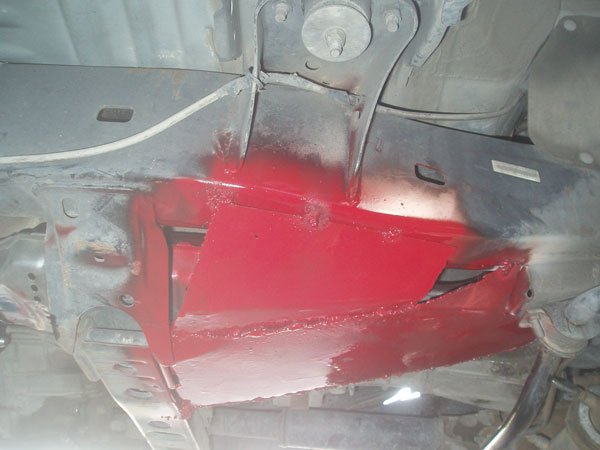

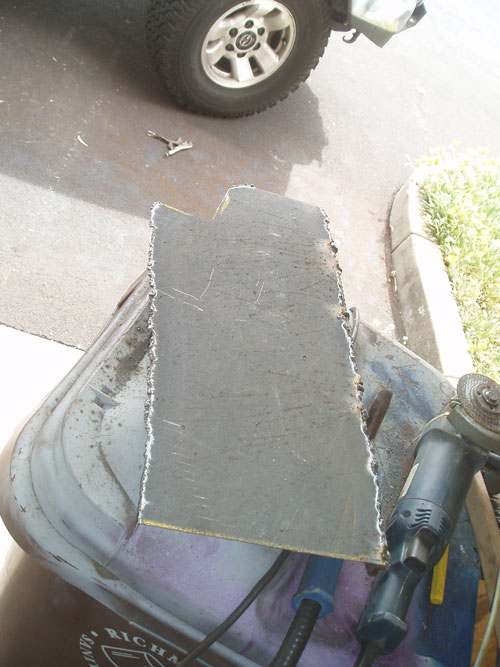

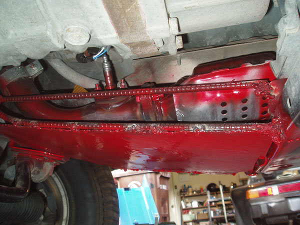

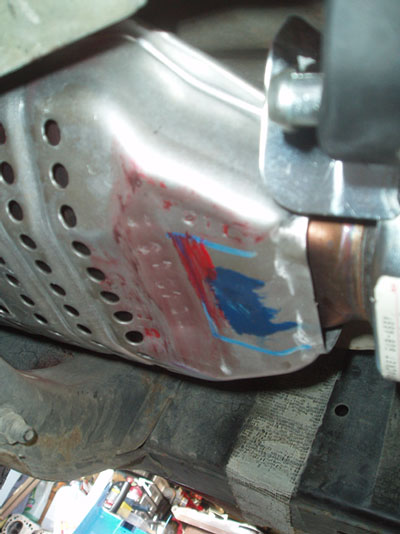

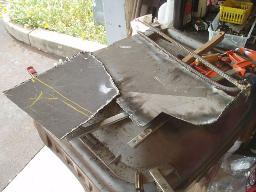

My solution to this problem. (IMG:style_emoticons/default/biggrin.gif)
I got a piece of scrap sheet metal and pieced together to fit nicely.
Then added additional high carbon steel (rebar) as a deterrent.
I stamped my phone number into the cat as well as a "911".
Painted red to be obvious of it's purpose.
I hope that the potential thief will see that they cannot cut the front of the cat and therefore cannot get away with it.
Only time will tell. (IMG:style_emoticons/default/popcorn[1].gif)
