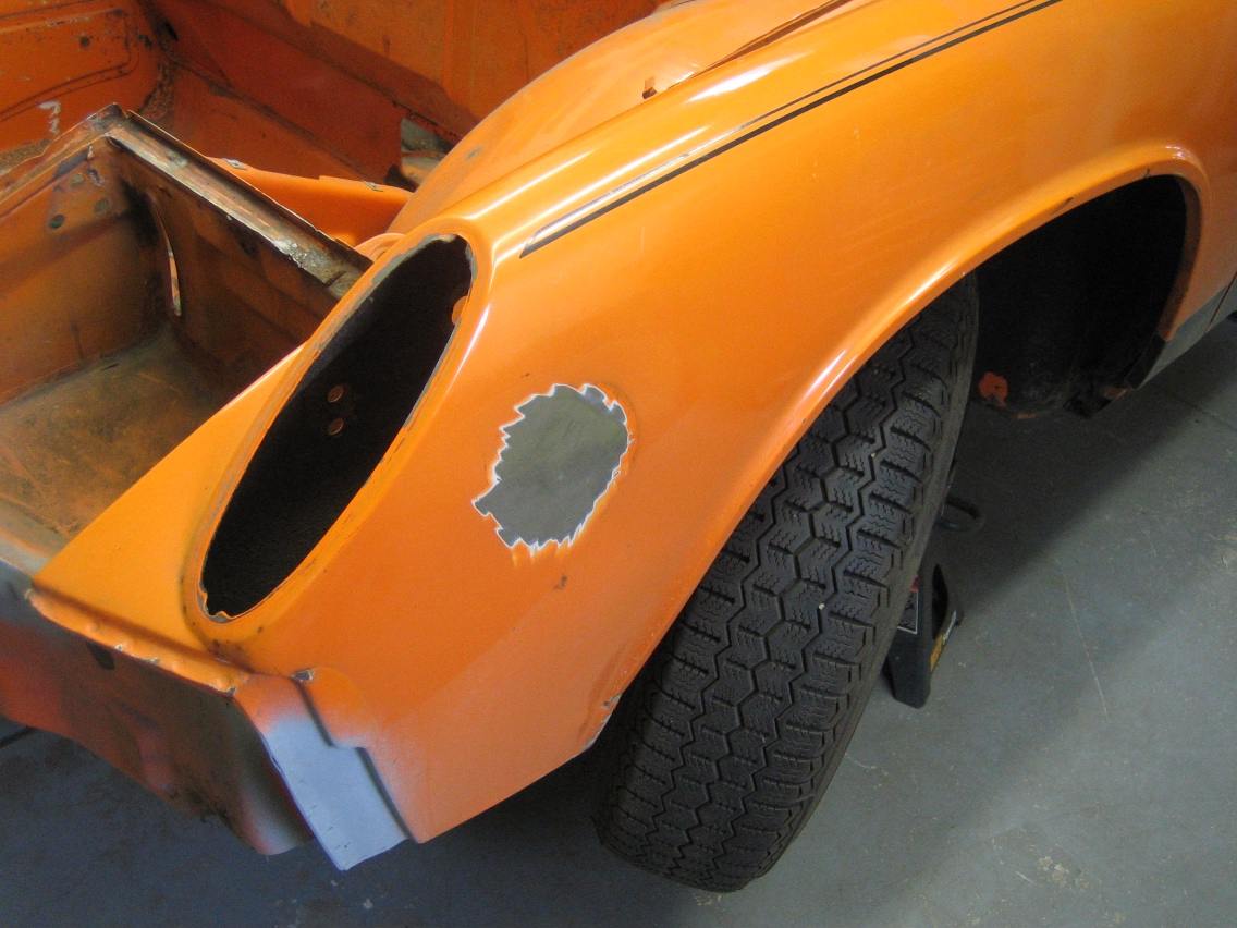

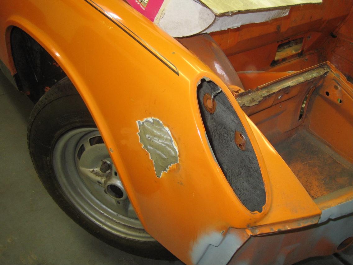

After grinding and 120 grit sander
Passenger side
