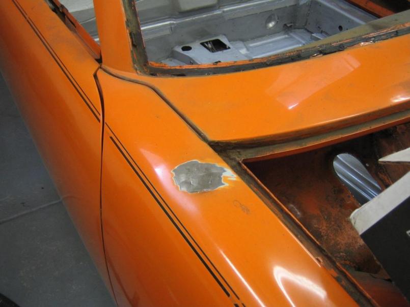

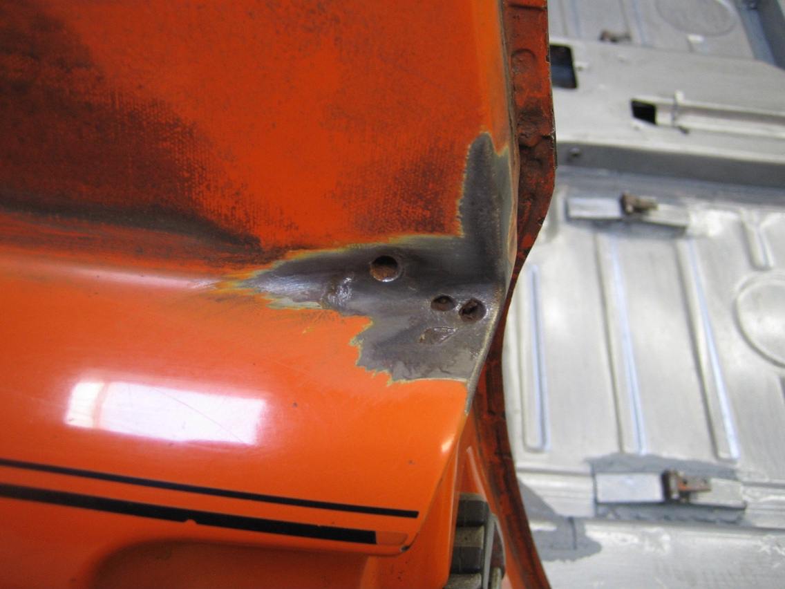

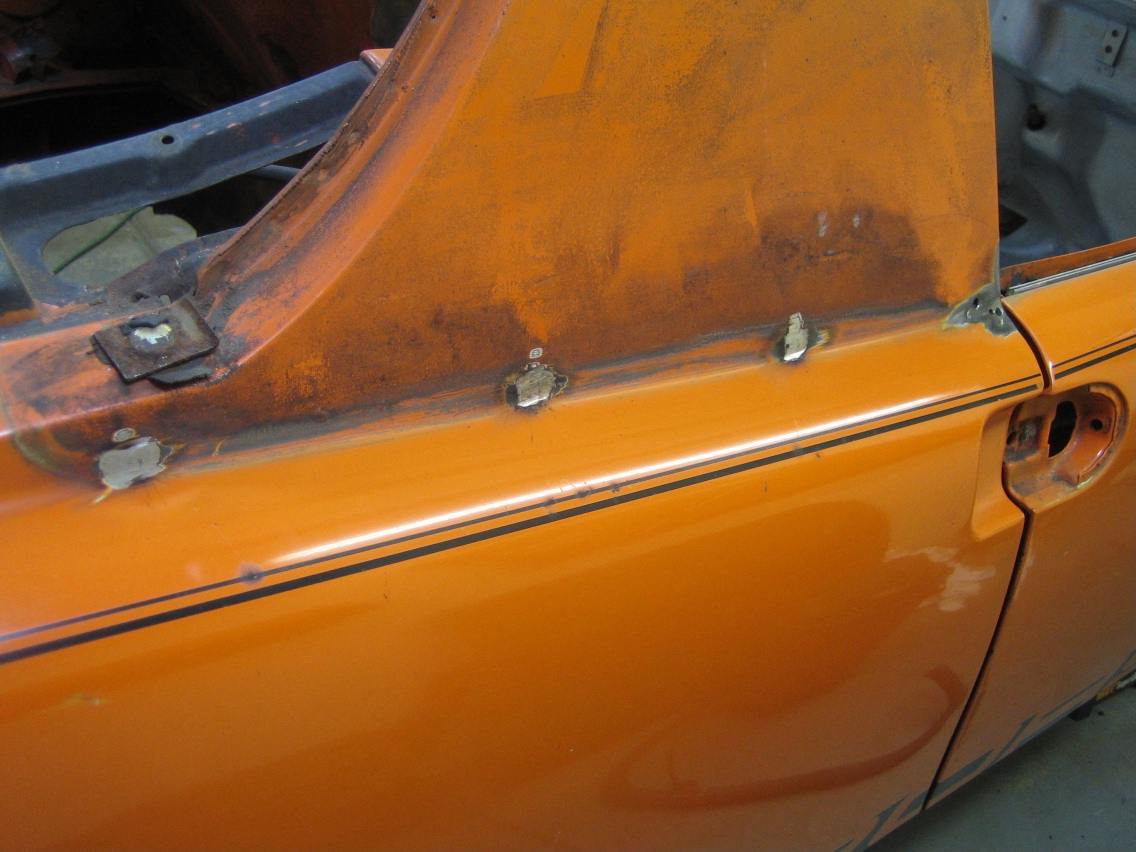

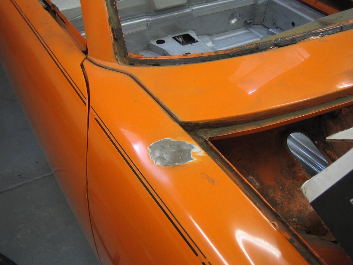

Antenna hole, this one did not come out as well ... I should have stopped for lunch, think blood sugar was low. Yeah I know excuses, excuses ...
Next up the sail panels, found some rust holes by the passenger door, will do something with those later.
