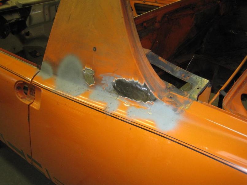

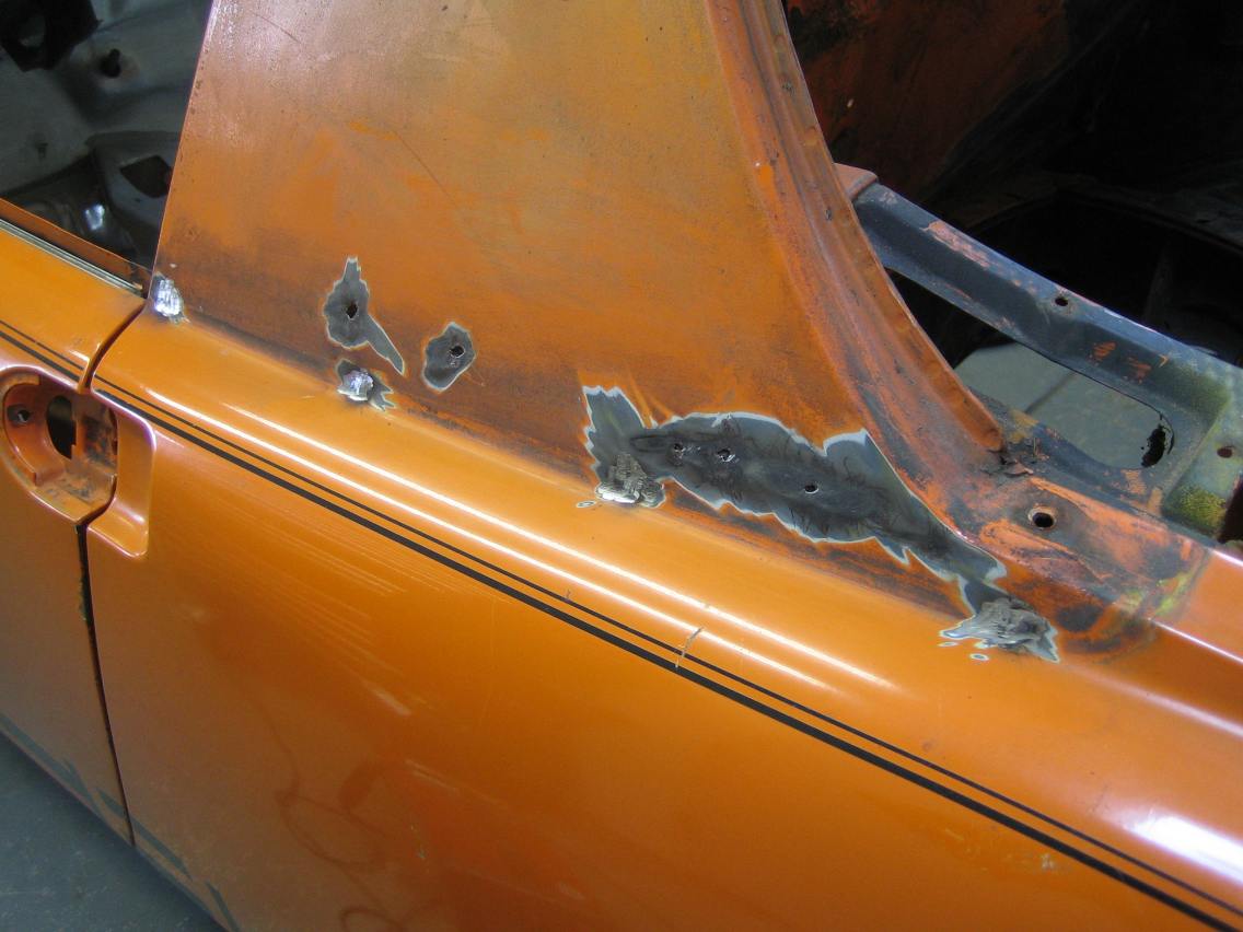

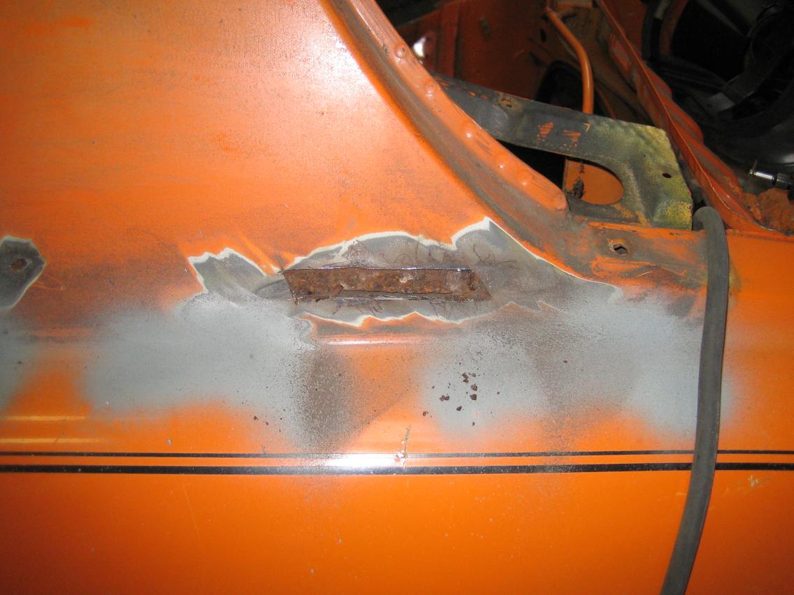

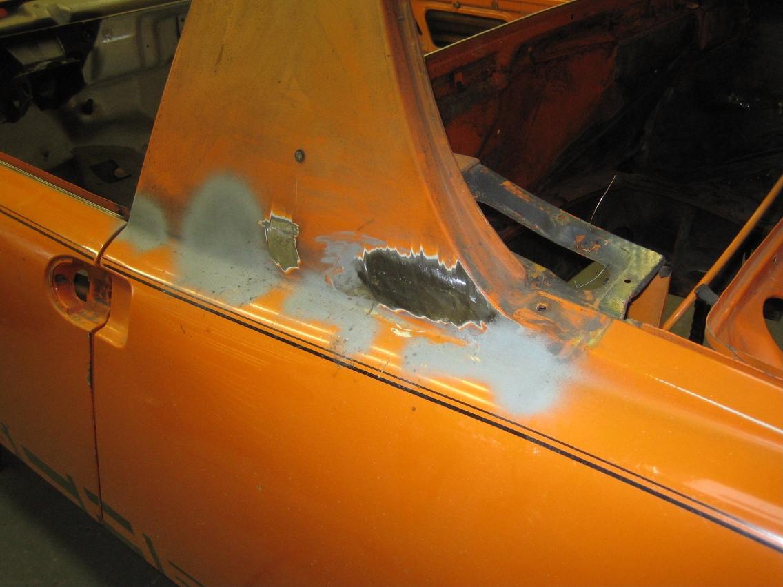

Finally the drivers side, I posted pics of the rust earlier in the thread, I cut out the offending areas and welded in new metal being careful with the heat so as not to warp the panels.
Next up I need to attach the seat rail enforcements under the car on the new floor panel, need to buy that compressor too .....
