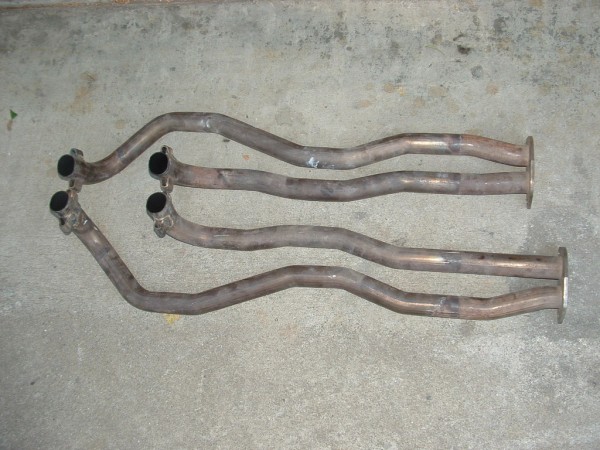

Something's not right. Smells like exhuast in the cabin, and a very slight backfire has developed on the left side...like a very subtle 'pop pop pop' at idle, and a more pronounced, single 'POP' on decel around 2800-3100 RPM. I've got it paired up to a Triad exhaust. What gives?
I swore to my wife that I wouldn't have the car up on ramps for a while since I just pulled it down (after 2.5 months) 2 days ago, so I took it to a custom exhaust place here in town and had them do the install. They said I needed new hoses (parts 21 & 23 here, hope you don't mind George!). The original ones were put back on, but they're pretty deteriorated and have small holes/cuts in them. Could that be it? I wish I understood how heat exchangers worked. I did a search on google hoping to learn just that but came up empty.

Lavanaut   Update ~ the shop was willing to refit the HEs for...   May 27 2008, 02:44 PM

Lavanaut   I doubt the pipe is leaking inside the tin but ma...   May 30 2008, 01:04 PM

Lavanaut   Yep, bummer. They look fine, just one very small ...   May 30 2008, 03:39 PM

Marty Yeoman   Are those your pipes in the picture? Why were the...   May 30 2008, 11:16 PM
Lavanaut   Went and picked up the car today. Check out the p...   Jun 5 2008, 01:50 PM
SirAndy   This was obviously not a split at the seam formed...   Jun 5 2008, 02:19 PM

TeenerTim   That's a huge amount rust for a stainless pipe...   Jun 5 2008, 02:54 PM

Lavanaut   One more, just for kicks. :wub:   Jun 5 2008, 01:51 PM
ericread   OK, You've roped us all in... Time to post ei...   Jun 5 2008, 02:01 PM

Marty Yeoman   Nice hole!! I knew Shayne would take good...   Jun 5 2008, 02:27 PM
Lavanaut   In just one of the pipes though? It seems like i...   Jun 5 2008, 02:32 PM

Lavanaut   ...that's exactly how the shop determine mine ...   Jun 9 2008, 10:19 PM
9146986   If your SSI's have cracks anything like that T...   Jun 10 2008, 09:58 AM
